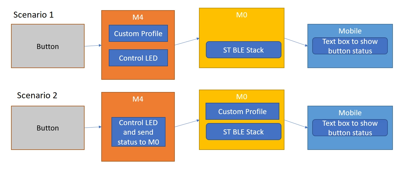

Can we load the BLE Custom profiles and services in M0 core of STM32WB55 and keep M4 core for applications?
We are currently using another IC for BLE and would like to build our expertise on stm32wb55.I made a custom profile following the scenario 1 with the help of Cubemx.
Will it be possible to use Scenario 2 were M4 core is used just for applications?

As far as i know... ST only releases the compiled binary files to flash your M0 processor, the precompiled code isnt available.
Which other BLE chip are you planning to use?
