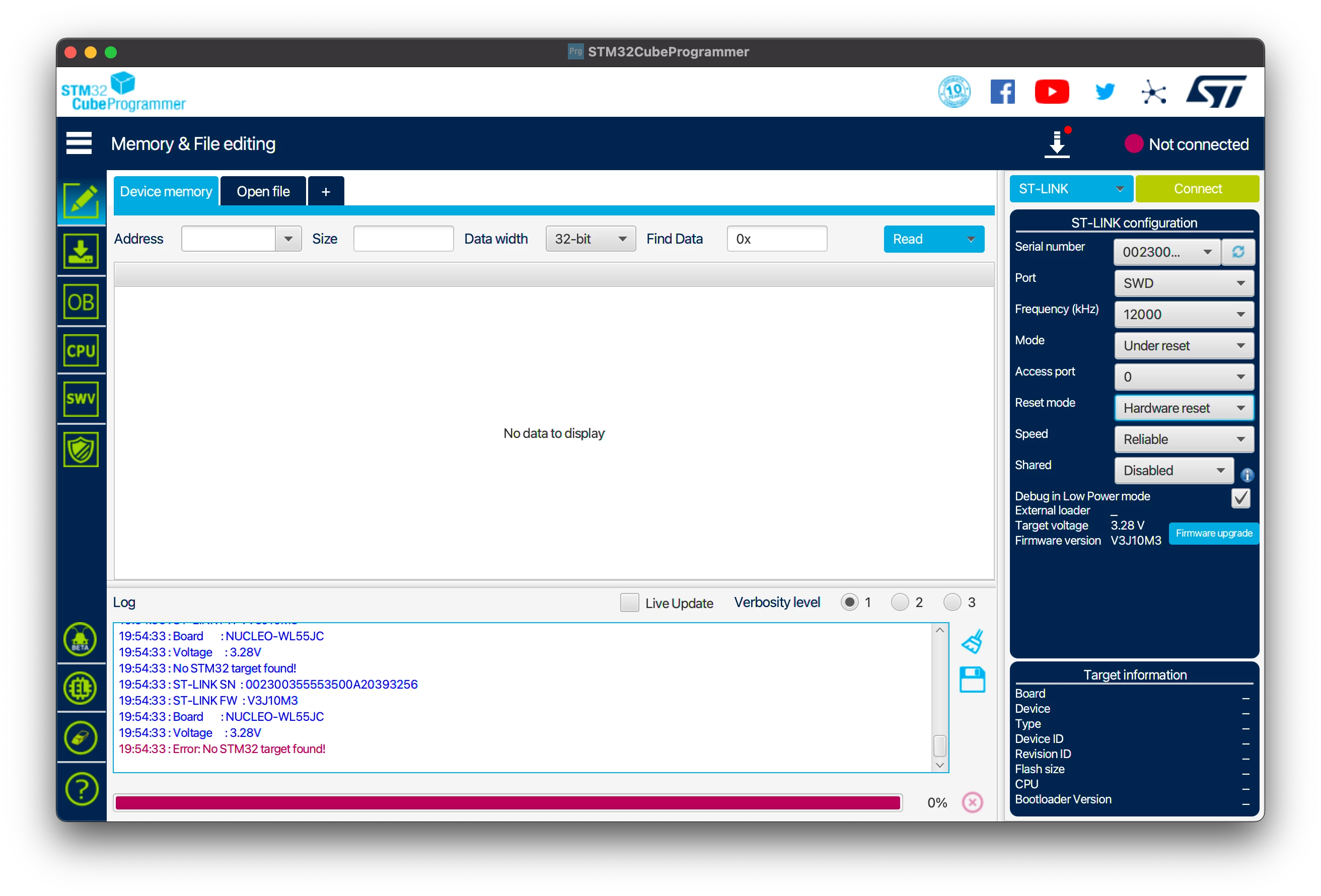

Can't read my STM32 Nucleo-WL55JC1 on the STM32Cube Programmer
Before this I'm launching my modified version of LoRaWAN_End_Node firmware, but my Nucleo Board keeps restarting and heating up so I unplugged the USB cable. When I tried to connect my board back I get a FAILS.txt file with the following content
The interface firmware FAILED to reset/halt the target MCU
I tried to connect my MCU to the STM32Cube Programmer with under reset configuration and trying all reset mode configuration but got no luck.
0693W00000aIfvmQAC.pngOther things that I've tried:
  1. Disconnect JP1
  2. Connecting while pushing the reset button
  3. Doing point 1 and 2 at the same time
And still got no luck.
Update:
Connecting the JP1 jumper back and the heating issue is back (the MCU isn't dead, I guess(?))
  1. The interface firmware FAILED to reset/halt the target MCU
That means the on-board ST-Link can't communicate with the STM32WL55 for whatever reason.
What part exactly is heating up ?
You may have a short-circuit somewhere.

It is around the block that contains both the MCU and LoRa chip. Only thing that I connect to the board is only a Teseo-LIV3FL module and I'm pretty sure it is not the one that caused any short-circuit since I've been using them for long time and got no problem. The heating issue is came after I tried to use the LoRa interface.
Tried on a spare board and the heating issue is gone (even with the LoRa interface turned on). I suspect the LoRa chip was defective since the heating issue only happening if the LoRa interface is turned on.
