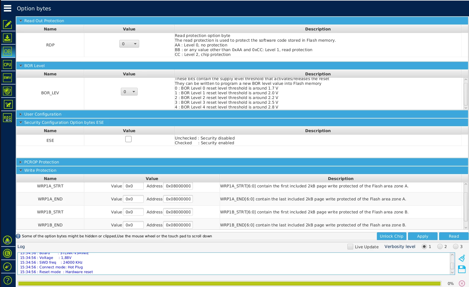

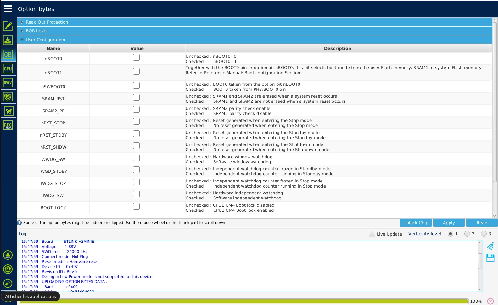

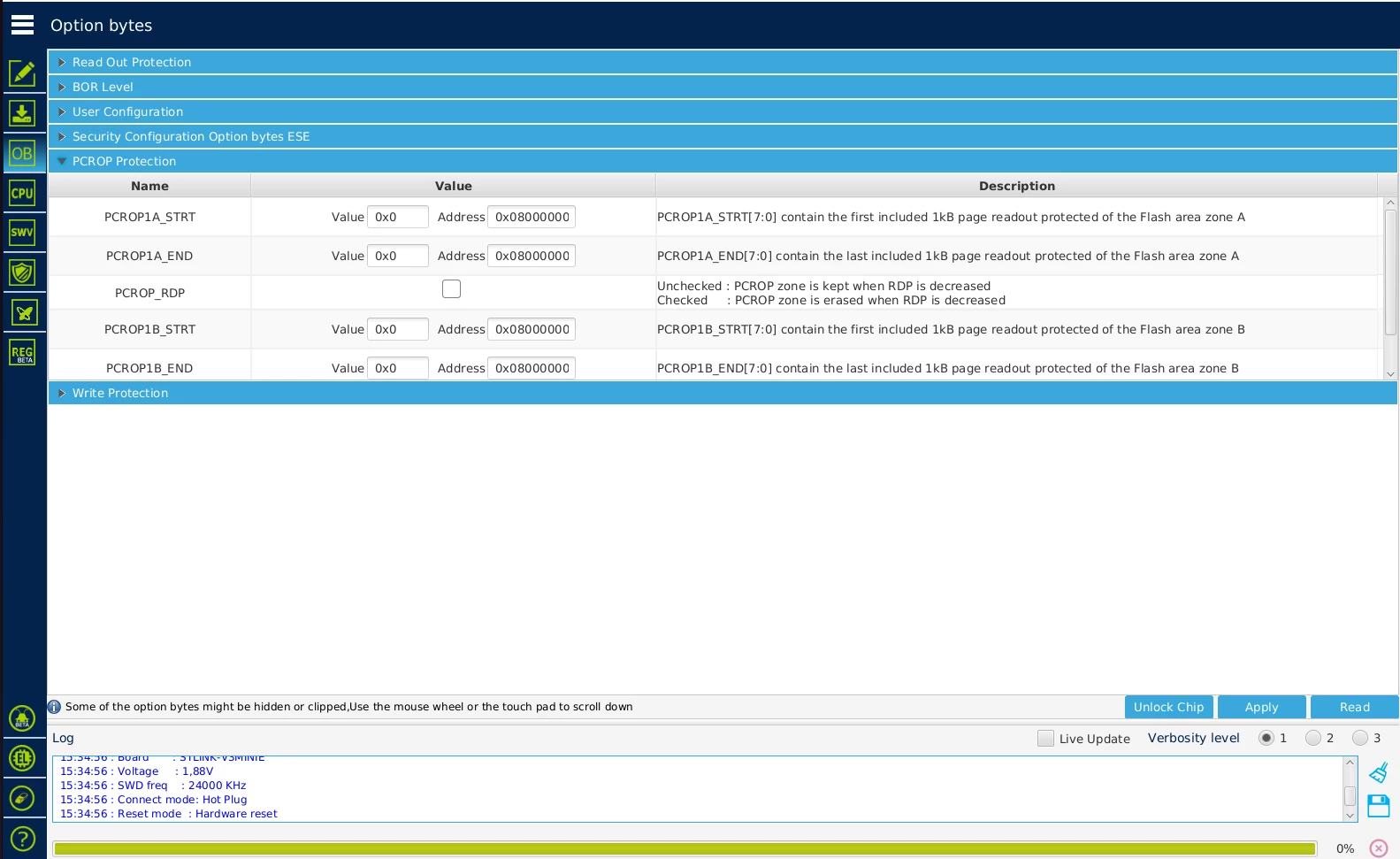

Here this what I have on OB Menu. RDP is set to 00, on SDK we have AA.
If i try to change to AA, STM32CubeProgrammer get stuck and crash on Linux (version v2.12.0) and STLIN-V3MINIE (version V3J10M3 STM32 Debug + VCP)
I have never program it, and all my board are in this state.

Hi @LEdou.1​,
the OB don't look healthy. It looks like the tools read all zeroes, which is not a default state and not even a valid state.
You are correctly trying to get the RDP to 0xAA value, this should normally trigger the regression and put the product to RDP0. Reading 0 in the RDP OB should be interpreted as RDP level 1, which should allow regression. I'm not aware of any exception.
I never encountered a situation where the STM32CubeProgrammer would crash, so this is really unknown territory for me. In your place it'd probably try using alternative tools. For example STlink v2, Windows machine, even the legacy ST-link Utility, the predecessor of STM32CubeProgrammer should support STM32WL (but probably not stlink v3).
