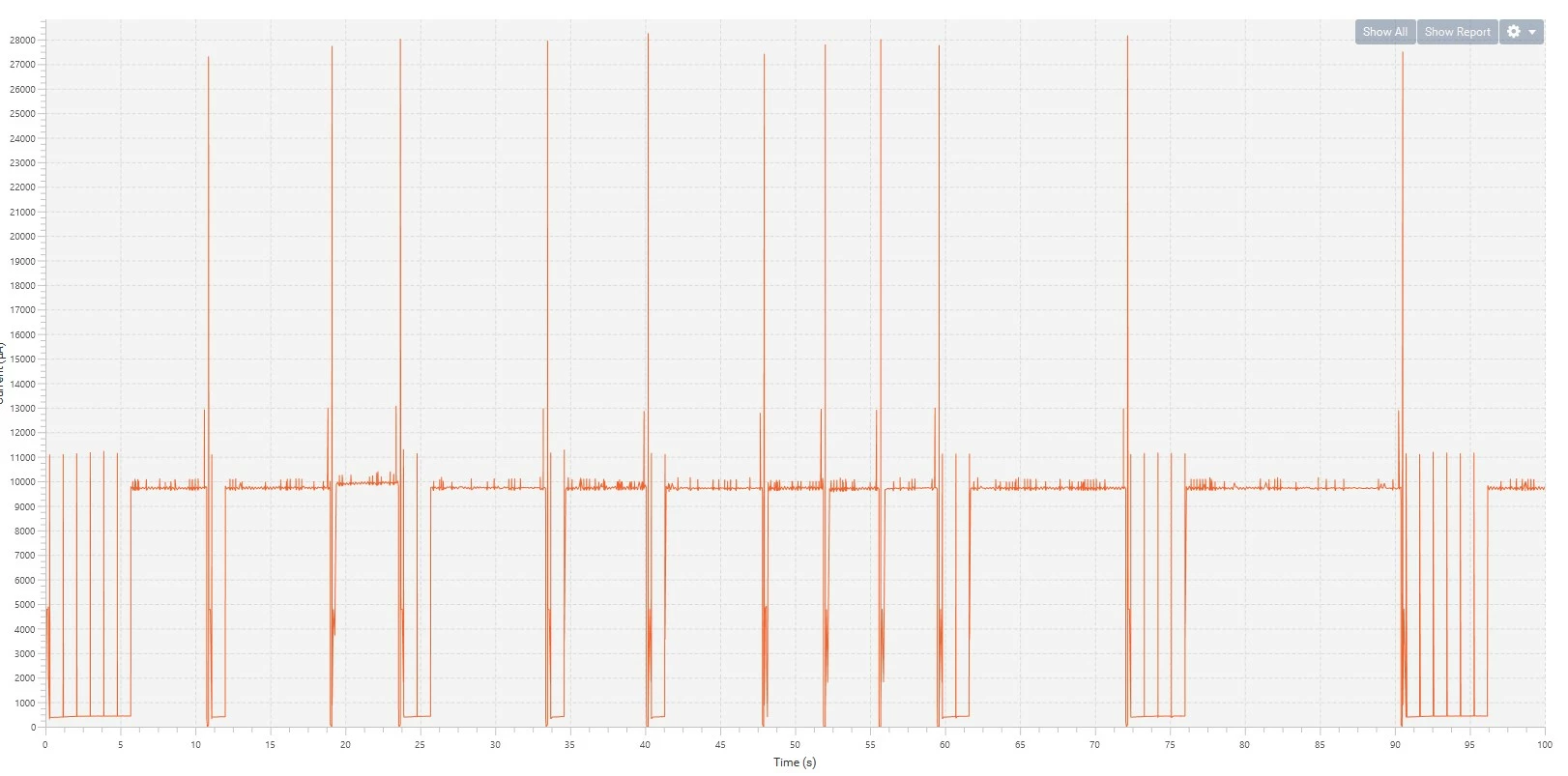

However, when I compiled and ran my project, it stopped advertising after a few packets. I tried to look at the power consumption to find out if I was getting stuck in STOP mode and unable to wake up, but this was not the case. The program was stuck in a loop after an arbitrary number of BLE advertising packets.
Here is a picture of that phenomenon, with spikes corresponding to resets of the device.
To find more details on what was happening, I used the debugger to see what the program was doing, and what I found was that the program was getting stuck when exiting low power mode, more specifically at this line in smp32_lpm_if.c in the ExitLowPower function :
while( LL_HSEM_1StepLock( HSEM, CFG_HW_RCC_SEMID) );
I tried to disable this line, to make it a 2-step lock, but nothing so far has corrected the issue. All other uses of the CFG_HW_RCC_SEMID are in the same file, and are followed not far away by a release of the lock.
In the end, I have not yet been able to find what was preventing the lock operation from being completed, and have no more ideas on what to look for.

What I was trying to do was indeed to put the WB55 into STOP2 mode when idle, not shutdown mode, I should not even have mentioned shutdown since it was not relevant to the question.
I looked around the BLE_HeartRate code example, comparing it to mine, and after a few days, I think I found what was wrong with my project.
The Flash clock was set to 16MHz, when the CPU2 clock was set to 32MHz. Setting the Flash clock to 32MHz seems to have fixed my issue, as I can now enter and exit STOP2 mode when idle without any problem.
