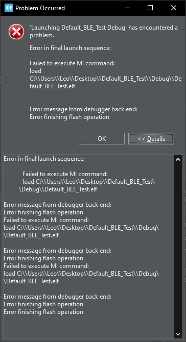

I was able to flash the board successfully many times but it suddenly stopped working when I changed something in the write protection settings. I think it was "WRP1B_END" which is currently 0x0807f80, but I don't remember the default value, maybe someone can tell what it is?
I am using STM32CubeProgrammer v2.14.0, MXCube 6.9.0 and STM32CubeIDE 1.13.0, which all seem to be up to date.
For example, when I try flashing the firmware via STM32Programmer (using newest formware from github master), I get this:

FUS info also looks weird?!
I also can't start the wireless stack:
I also can't flash user code, I get this:
Error: Data mismatch found at address 0x08000000 (byte = 0xFF instead of 0x7F)
Error: Download verification failed
Warning: The core is locked up
When trying to flash user code with STM32CubeIDE I get this:
testerBest answer
Jul 26, 2023 1:17 PM UTC
I think I fixed it by setting
WRP1B_STRT to Value "0xff" and Address "0x0807f800" and
WRP1B_END  value to "0x0" and address "0x08000000"
