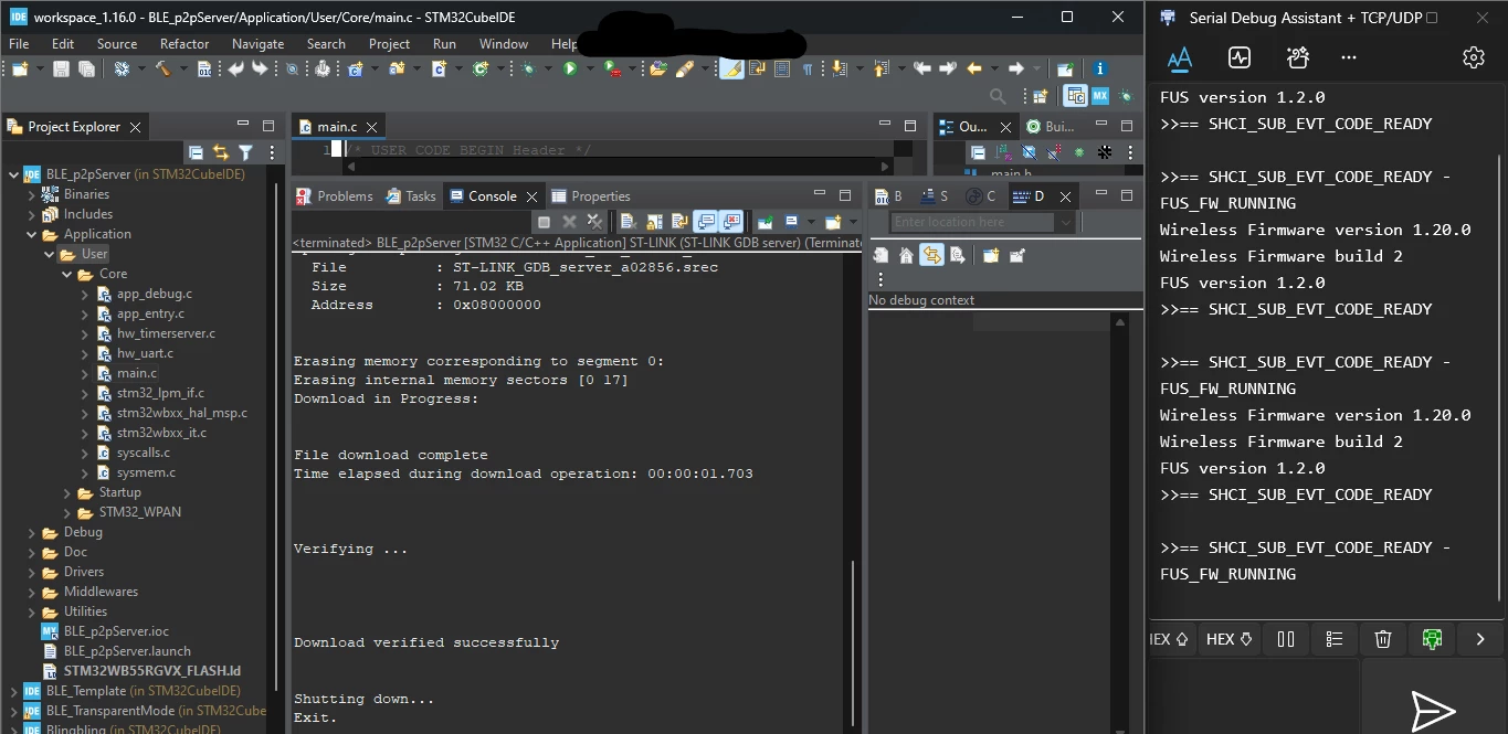

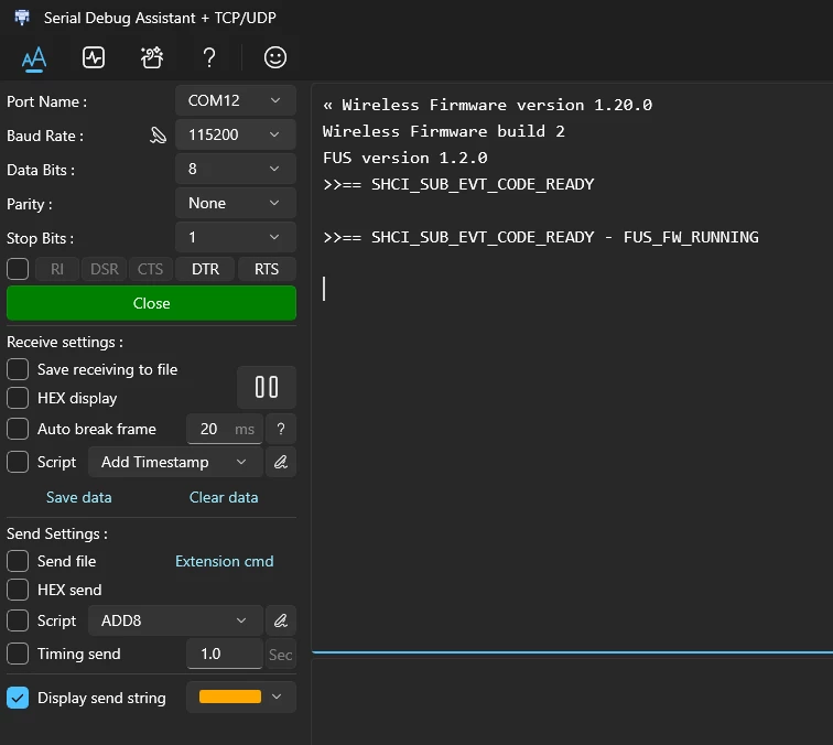

I have a problem STM32WB55RG, i download BLE_p2pServer firmware to the board and success in stm32cubeide, but board can't run the firmware and i try download with stm32cubeprogrammer and i have same problem.

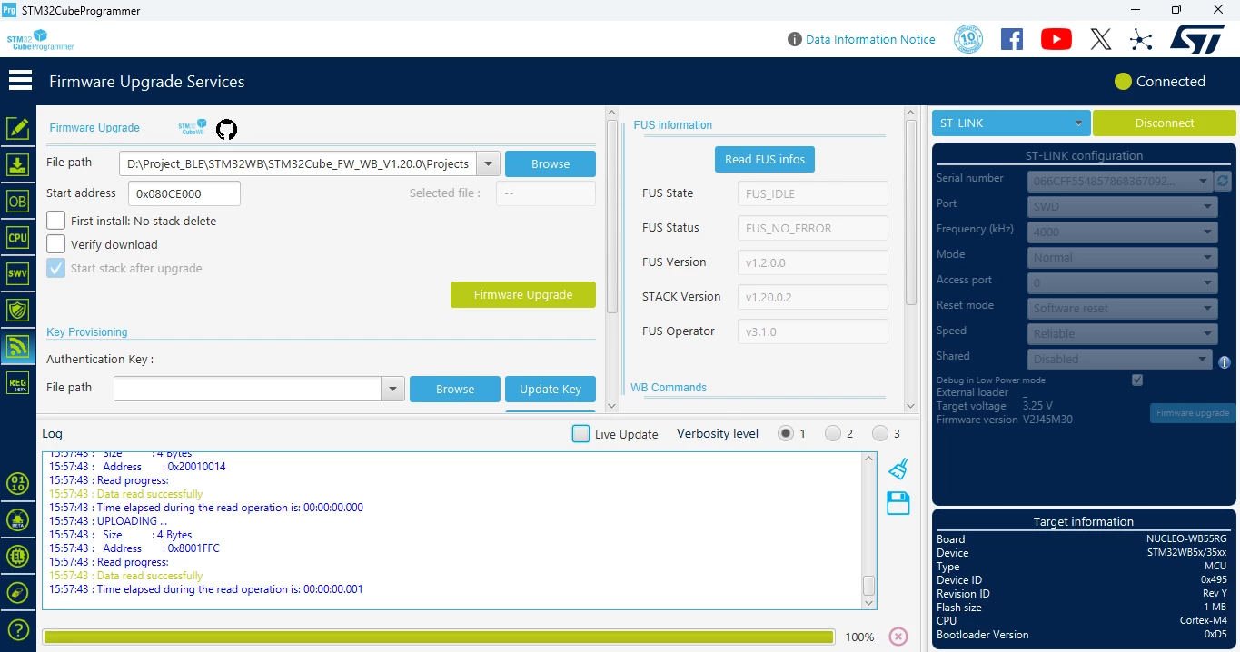

Hello @Aboyh
This application requires having the stm32wb5x_BLE_Stack_full_fw.bin binary flashed on the Wireless Coprocessor (available here). So, please do a Stack update with this .bin. Then, start the wireless stack using the button "Start wireless stack" on the Cube Programmer interface:
Then, it should work fine.

I have tried it but the problem still occurs on my device
STTwo-32
Aug 22, 2024 2:01 PM UTC
Have you clicked on the button "Start Wireless Stack" after upgrading stack and firmware and before uploading your application. I think this is why you have this problem.
Best Regards
