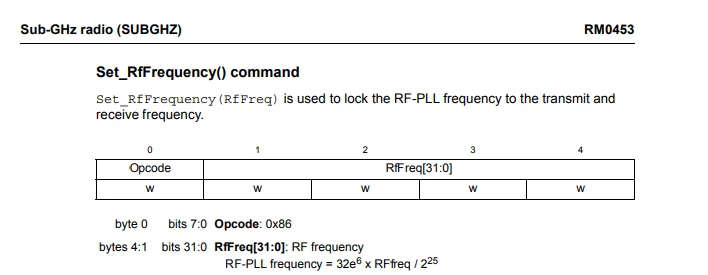

I'm working on an application that uses the NUCLEO-WL55JC development board. I was looking in the SubGHz_Phy_PingPong example code, and I noticed a macro called SX_FREQ_TO_CHANNEL. To use this macro, it seems you input the carrier wave frequency you want to transmit at, and it converts it to the value you pass as an array of 8-bit numbers to HAL_SUBGHZ_ExecSetCmd(&hsubghz, RADIO_SET_RFFREQUENCY, array, arr_len).
So if I want to transmit at 868 MHz, I give that value to SX_FREQ_TO_CHANNEL, which outputs 910,163,968. But why is SX_FREQ_TO_CHANNEL needed at all? Why can't I pass 868,000,000 directly in the RADIO_SET_RFFREQUENCY packet?
I think it has something to do with the RF-PLL frequency, but I don't understand. Can someone help explain why RADIO_SET_RFFREQUENCY doesn't actually set RF-PLL to frequency included in the packet?

The SX_FREQ_TO_CHANNEL(chan, frequency) take the frequency (in MHZ) and calculate the RfFreq that will be addeed to the Set_RfFrequency() command:
Refer to the chapter 5 of the RM0453 for more details.

I figured the macro was used because it efficiently does the calculation, but I still don't understand why we need to convert the number at all.
Let me ask my question a different way: when I want to transmit at 868 MHz, why am I calling the RADIO_SET_FREQUENCY command and giving it 910,163,968? I don't want the center frequency at 910 MHz, I want it at 868 MHz. If I called the RADIO_SET_FREQUENCY command and gave it 868,000,000, what would my center frequency be then?

I've just updated my comment. The new version should have give more data.
