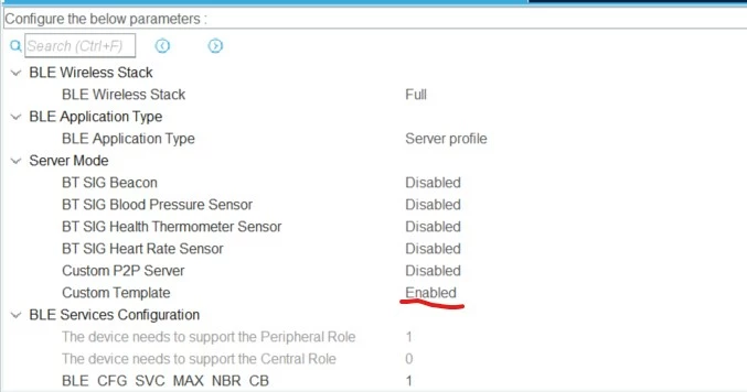

I am trying to build my own BLE application for STM32WB5MMGHx using cubeMX with BLE custom Template , I followed all the needed steps to configure BLE APP the advertising data, services and chars. the projects build but nothing work.
_legacyfs_online_stmicro_images_0693W00000bi6SMQAY.pngI debugged my projects and I found that I didn't get any interruption on IPCC (RX/TX handlers) after initializing the BLE stack.

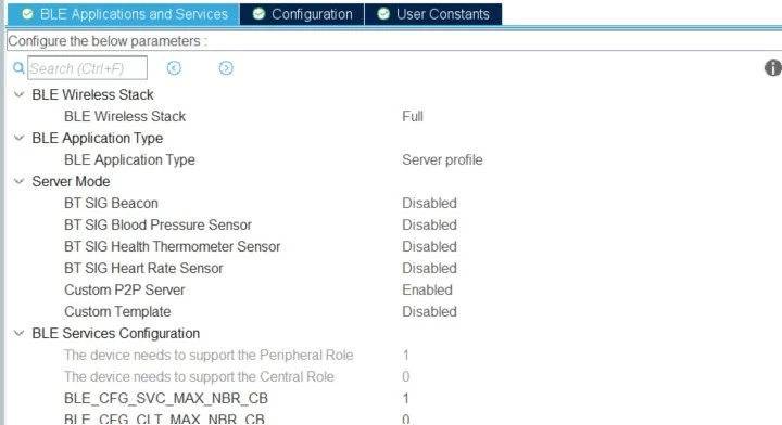

I tried also to use the same steps with Custom P2P server and it doesn't work for me and I have the same symptoms.

Indeed, there is an extra dot in CubeIDE linker file: *(.MB_MEM2) ; instead of *(MB_MEM2) ;
Due to this, the buffers that need to be in SRAM2 are not placed there, so your application doesn't work. It will be corrected in the next release.
