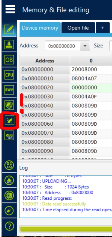

Bug REPORT: CubeProgrammer 2.18 does not show SigFox credential button
Hi
I debugged the Sigfox AT_Slave example in stmcubeWLv1.3.0 package.
All tutorials show how to get the board sigfox credentials through CubeProgrammer software, which once connected with a STM32WL device, shows an extra button called "sigfox credentials" (in figure).
However, this does not work for me with the last 2.18 version of CubeProgrammer (tested on 2 different PCs). I had to unistall the software ad get the previous 2.17 version in order to display the extra button.

Hi @smassardi
The Sigfox Credential menu should appear at the right hand side of the GUI in v2.18. This is not a bug in the tool, it's just that a right  hand side hamburger menu have been added.
Could you check on your side and get back to us please ?
Aziz
