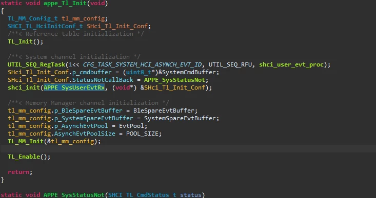

Earlier this week I updated the Cube IDE to 1.11 and with it updated the firmware for the wb5 to 1.15.0.
After the update new projects created on the 1.15 firmware would not advertise.
APP_BLE_Init(void) (app_ble.c) was never called because the function where it was called in was registered as a Task but never set.
Function calls were as follows:
  • app_entry.c: appe_Tl_Init(void) was called
  • In this function shci_user_evt_proc is registered as task for the sequencer
  • Also APPE_SysUserEvtRx is passed as a function pointer
    • This function is important because: APPE_SysUserEvtRx (app_entry.c) -> APPE_SysEvtReadyProcessing (app_entry.c) -> APP_BLE_Init (app_ble.c)
  • In shci_user_evt_proc the passed function pointer of APPE_SysUserEvtRx is called
  • shci_user_evt_proc is registered but never set and therefore never called. In stm32_seq.c: UTIL_SEQ_RegTask() was called UTIL_SEQ_SetTask() was never called
It is important to notice that projects created with firmare 1.14.1 and migrated to 1.15.0 did not have this issue and worked like before.
Just projects created on the 1.15.0 firmware showed this issue. I created mutliple (8) projects and tried different BLE configurations, all with the same issue.
It would have helped a lot if the new IDE version 1.11 would have been still able to change the firmware version of both new projects in the creation dialog and existing projects in the .ioc file in Project Manager.
In the end I deinstalled the IDE and downloaded the 1.10 to work with firmware 1.14.1. Now everything is working again.

Which version of BLE Stack are you using? When the issue occurs did you received the ready event from CPU2 (SHCI_SUB_EVT_CODE_READY) or not? Where is stuck the code when the issue occurs?

The Version for BLE Stack:
stm32wb5x_BLE_Stack_full_extended_fw.bin: V1.15.0
stm32wb5x_BLE_Stack_full_fw.bin: V1.15.0
stm32wb5x_BLE_Stack_light_fw.bin: V1.15.0
Where can I see the SHCI_SUB_EVT_CODE_READY?
The code is not stuck at all, just the functions mentioned above are never reached and therefore the BLE is not initialized. The main loop runs fine.

Remy ISSALYS
January 9, 2023
With the stm32wb5x_BLE_Stack_full_fw.bin, if you generate a P2P Server, is it working?
You can see the SHCI_SUB_EVT_CODE_READY event in APPE_SysUserEvtRx function see app_entry.c file.

January 10, 2023
Hello @Remy ISSALYS​ ,
Thank you very much for your help! with the stm32wb5x_BLE_Stack_full_fw.bin it is finally working :)
