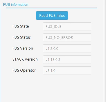

What is the Version of FUS implemented on your MCU.

sorry @STTwo-32  for late response, I was on vacation and didn't have access to work account.
Here are the requested infos:

Hello @KlemenDS
Could you provide more details about your option bytes values. Also, what are the PINs that you are using for USART1?
