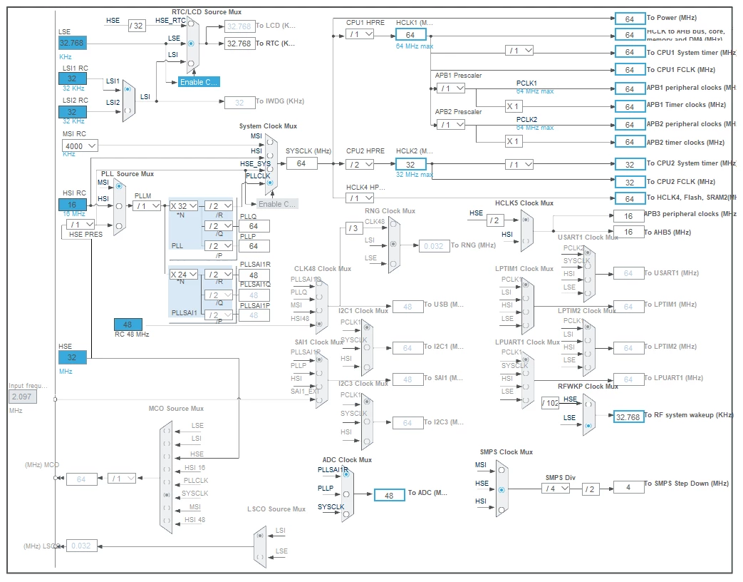

Yes, the clock configuration is set like this:
void SystemClock_Config(void)
 /** Configure LSE Drive Capability
 HAL_PWR_EnableBkUpAccess();
 __HAL_RCC_LSEDRIVE_CONFIG(RCC_LSEDRIVE_LOW);
 __HAL_PWR_VOLTAGESCALING_CONFIG(PWR_REGULATOR_VOLTAGE_SCALE1);
 RCC_OscInitStruct.OscillatorType = RCC_OSCILLATORTYPE_HSI|RCC_OSCILLATORTYPE_HSE
               |RCC_OSCILLATORTYPE_LSE|RCC_OSCILLATORTYPE_MSI;
 RCC_OscInitStruct.HSEState = RCC_HSE_ON;
 RCC_OscInitStruct.LSEState = RCC_LSE_ON;
 RCC_OscInitStruct.MSIState = RCC_MSI_ON;
 RCC_OscInitStruct.MSICalibrationValue = RCC_MSICALIBRATION_DEFAULT;
 RCC_OscInitStruct.MSIClockRange = RCC_MSIRANGE_6;
 RCC_OscInitStruct.PLL.PLLSource = RCC_PLLSOURCE_MSI;
 RCC_OscInitStruct.PLL.PLLM = RCC_PLLM_DIV1;
 RCC_OscInitStruct.PLL.PLLN = 32;
 RCC_OscInitStruct.PLL.PLLP = RCC_PLLP_DIV2;
 RCC_OscInitStruct.PLL.PLLR = RCC_PLLR_DIV2;
 RCC_OscInitStruct.PLL.PLLQ = RCC_PLLQ_DIV2;
  Error_Handler();
 /** Configure the SYSCLKSource, HCLK, PCLK1 and PCLK2 clocks dividers
 RCC_ClkInitStruct.ClockType = RCC_CLOCKTYPE_HCLK4|RCC_CLOCKTYPE_HCLK2
               |RCC_CLOCKTYPE_HCLK|RCC_CLOCKTYPE_SYSCLK
 RCC_ClkInitStruct.APB1CLKDivider = RCC_HCLK_DIV1;
 RCC_ClkInitStruct.APB2CLKDivider = RCC_HCLK_DIV1;
 RCC_ClkInitStruct.AHBCLK2Divider = RCC_SYSCLK_DIV2;
 RCC_ClkInitStruct.AHBCLK4Divider = RCC_SYSCLK_DIV1;
 if (HAL_RCC_ClockConfig(&RCC_ClkInitStruct, FLASH_LATENCY_3) != HAL_OK)
  Error_Handler();
I'LL also attach a screenshot so you can see it easily.

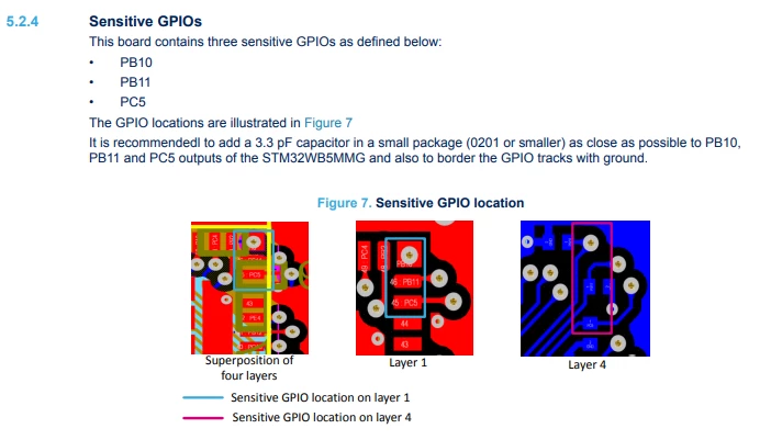

You can try to change the LSE drive setting from RCC_LSEDRIVE_LOW to RCC_LSEDRIVE_HIGH. According to the datasheet on STM32WB5MMG there is three sensitive GPIOS, maybe you used one these GPIOs:
0693W00000NpmrlQAB.pngBest Regards

I realized that the sensitive GPIOs doesn't have the corresponding capacitors thanks to your answer, however, I use these pins only for an external memory that I'm not using at this moment, so I'm not using them for the communication with any of the sensors (BMI or BMM).
