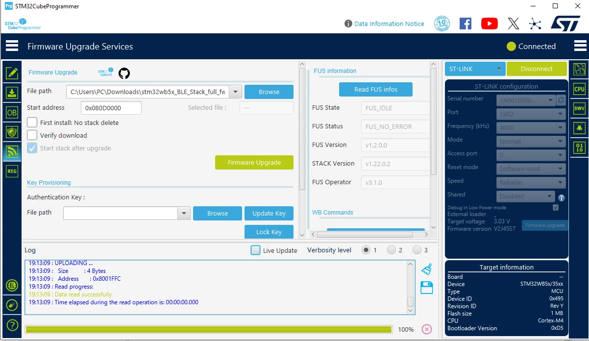

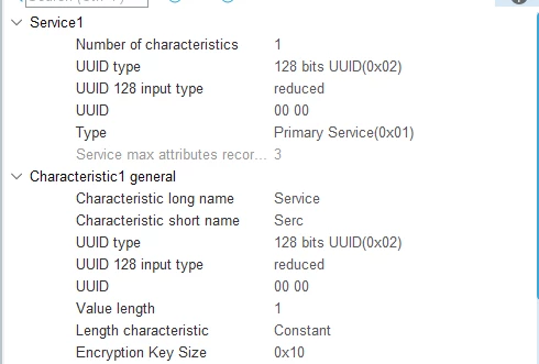

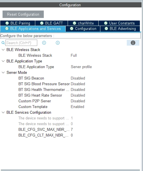

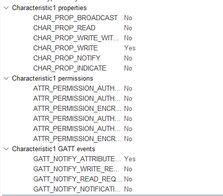

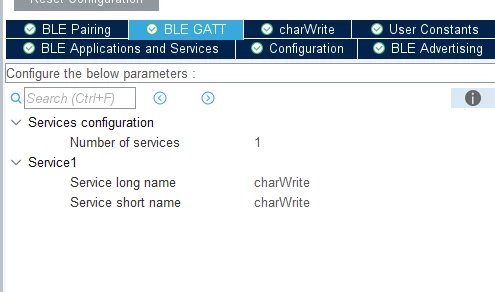

I tried to setup BLE, I do not know how I managed first time to success - but I can't do it anymore :D
Once it was working and even tried to send characters, but now I cant setup it anymore.
I follow up https://wiki.stmicroelectronics.cn/stm32mcu/wiki/Connectivity:STM32WB_BLE_STM32CubeMX?fbclid=IwY2xjawJKMGtleHRuA2FlbQIxMAABHWGApJ2fFnP-RI3Ye1iESDwJcYOT4JPv8skeIeo9BnIwXsOjudiwk5aLvg_aem_JjqKEMTM7yBJXIqLLMAUGQ#STM32_WPAN_configuration
and
https://www.youtube.com/watch?v=1LvfBC_P6eg&t=4s
I did FUS start before updating:
BLUETOOTH_2-1742577253064.pngBLUETOOTH_3-1742577279388.pngBLUETOOTH_4-1742577290756.png
It seems like I did exactly like in examples, but it doesnt even appear in ST BLE Toolbox app,
will appreciate any kind of help !
