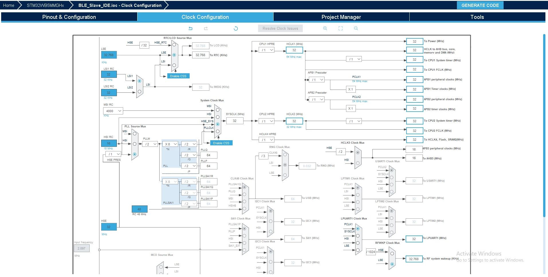

Hello all,
                  I made custom PCB board with STM32WB5MMG in my project.
I have confirmed that the SWD pins are working and Code is Debugging ok.I have also set up HSEM, IPCC, RCC, RTC, RF, STM32_WPAN required but I can't detect the Bluetooth.
Iam using  STM32CUBEMX V6.8.1 and STM32CUBEIDE V1.12.1
Firmware package version is 1.16.0 (STM32Cube_FW_WB V1.16.0)

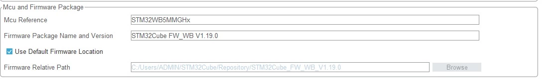

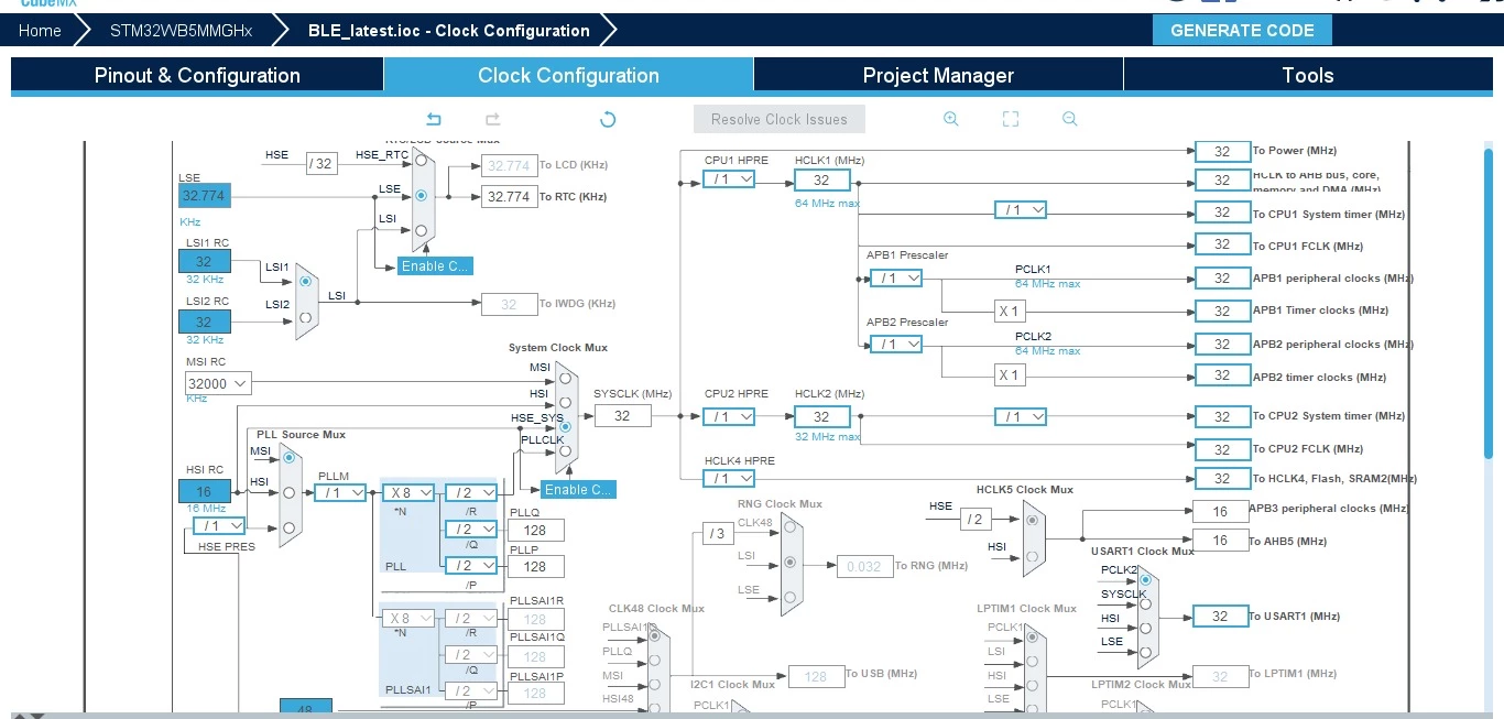

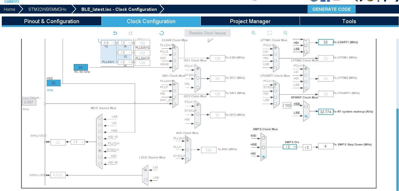

KavinrajAuthor
Apr 1, 2024 1:41 PM UTC
Hello @STTwo-32 ,
       I am trying my code in STM32Cube_FW_WB V1.19.0, the STM32CubeMX V6.11.0 and the STM32CubeIDE V1.15.0. configuration but same result bluetooth is not detecting.After I'm  trying example codes of STM32WB5MM-DK  but Im not able build and flash, so guide me to build that codes in right way.
These are screenshots of clock configuration of my project,WhatsApp Image 2024-04-01 at 6.58.40 PM.jpegWhatsApp Image 2024-04-01 at 6.59.09 PM.jpegFirmware PackageFirmware Package

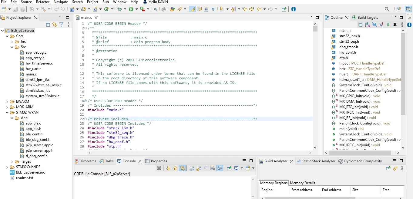

STTwo-32
Apr 1, 2024 2:40 PM UTC
If you want to set your own example from scratch, I suggest you refer to the Steps of the WIKI mentioned on my first comment. For the BLE_p2pServer, I suggest you import it as follow:
  • File -> Open Projects from File System.
  • Click on Directory and select this Directory "...STM32Cube_FW_WB_V1.19.0\Projects\STM32WB5MM-DK\Applications\BLE\BLE_p2pServer" then select the STM32CubeIDE File and Click on "Select Folder". Then Finish.
Now, you will be able to Build your project.
Best Regards.
STTwo-32
KavinrajAuthor
Apr 2, 2024 7:44 AM UTC
   I'm trying as per the your guidence, the example code was builded successfully and flashed but still couldn't find bluetooth on my phone ,If any additional bin files are need to flash or not(like stm32wb5x_FUS_fw.bin,stm32wb5x_FUS_fw_for_fus_0_5_3.bin).

KavinrajAuthor
Apr 2, 2024 12:36 PM UTC
Dear @STTwo-32 ,
                       After Firmware upgrade,now bluetooth is detecting thankyou so much sir, If any  further doubts
I will post in ST Community
