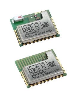

actually, i'm using the bluetooth module BlueNRG-M2 , and i want to know the communication distance in meter please and the length of the antenna .
Thank you
There are 2 versions:
  1. On-board chip antenna (BLUENRG-M2SA);
  2. PCB antenna (BLUENRG-M2SP).
https://www.st.com/en/wireless-connectivity/bluenrg-m2.html
So which one do you have?
Dimensions are in the datasheet.
Achievable range will depend very much on the application.

thanks for replying, i have both of them :
Also if it's possible to  recommand me other bluetooth BLE reference better.
Thank you very much

i want a BLE bluetooth module with range between 10 m and 30 m and, above all, is not sensitive to interferences. (also like option if it can i use it with arduino ).
Thanks
Again, that's really not something that can be specified for a module alone - it depends very much on the rest of the system
In general, BLE should be able to achieve 10-30m unobstructed - but obstructions (your product casing, people, walls, etc) will reduce that.
That would fall within the BLE specs.
Anything can be used with Arduino - it's just (sic) a matter of having the right code ...

Means that the distance of communication using the
is + 10m ?
also please i want to be sure about the baud rate using this module ( baud rate of my application between 9600 and 115200) and how many bytes / S
thank you very much

Again, that's really not something that can be specified for a module alone - it depends very much on the rest of the system.
This is why manufacturers do evaluation modules - so that you can try it out in your particular system & conditions.
The supported baud rates will be specified in the datasheet.
