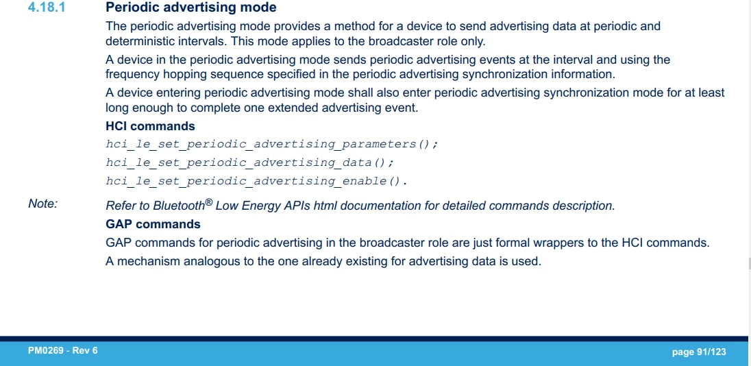

Hello all. Can you help me?
According to the PM0269 I need to use sone API function for periodic advertising. Where is hci_le_set_periodic_advertising_data() finction? There is no hci_le_set_periodic_advertising_data() finction prototype in bluenrg_lp_api.h header file. I only saw the aci_gap_set_periodic_advertising_data() function prototype for use.
Thank you for your attention.

Hello @AndyZel
This Command is available on the line 2085 of the bluenrg_lp_hci_le.h.
Best Regards.
