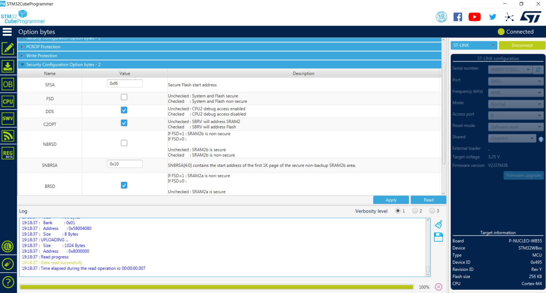

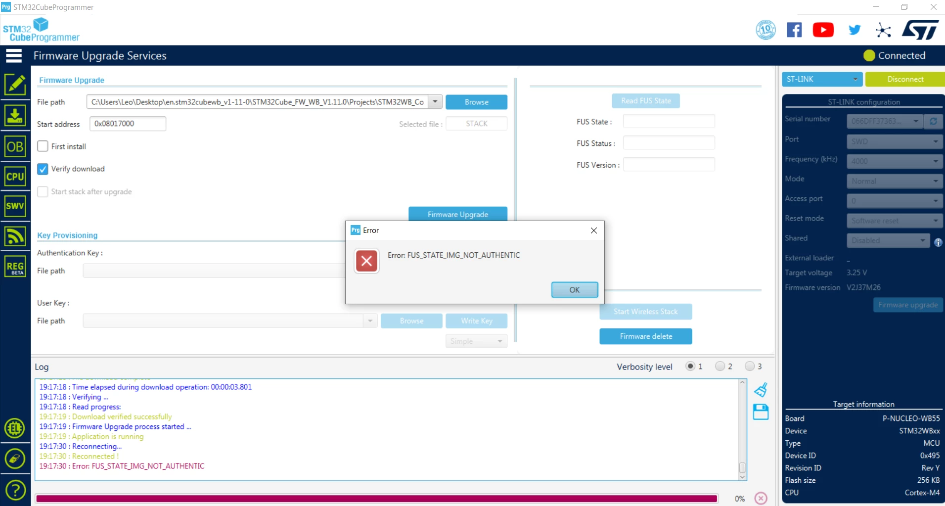

Leo Tai
Leo TaiAuthor
Apr 18, 2021 10:52 AM UTC
https://community.st.com/s/question/0D53W00000CQ1gqSAD/ble-stack-installation
According to the above question, one answer mentioned about the option bytes SFSA should be 0xCB if Full BLE Stack is installed. I checked the nucleo board and the SFSA value is 0xCB. However, if I look at the SFSA in my case, it was shown as 0xF6. It seems that I failed to install the BLE stack.

Remi QUINTINBest answer
Apr 27, 2021 1:21 PM UTC
If SFSA was shown as 0xF6, then you have a very old FUS that needs to be upgraded to properly installed the most recent FW versions .
So, you first have to upgrade the FUS to version 1.0.2 using the stm32wb5x_FUS_fw_1_0_2.bin binary under the STM32Cube_FW_WB_V1.11.0\Projects\STM32WB_Copro_Wireless_Binaries\STM32WB5x directory. The SFSA should then be 0xF4.
Then execute the same with the stm32wb5x_FUS_fw.bin binary at the same location. The SFSA should not change with this second upgrade.
With this latest version (v1.1.0), you should get no error as more commands are supported.
