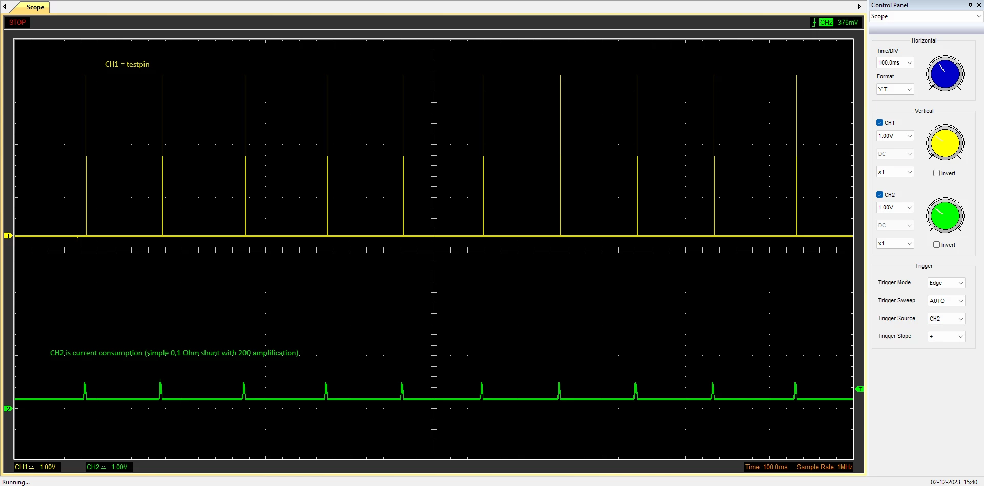

as I understand it:
I can activate the low power manager in CubeIDE. This will automatically add code, so each time the Sequencer has nothing to do, the system enters low power mode.
So far, this works. I can see it in the current consumption.
What I don´t understand: Is the HSE deactivated during sleep? I think it has to be, otherwise the current consumption should be much higher. But I cannot confirm it, when I use a scope and set test point in the code.
If I go to the file stm32_lpm_if.c and edit:
static void EnterLowPower(void)
* This function is called from CRITICAL SECTION
HAL_GPIO_WritePin(testpin_GPIO_Port, testpin_Pin, 0);
and
static void ExitLowPower(void)
HAL_GPIO_WritePin(testpin_GPIO_Port, testpin_Pin, 1);
/* Release ENTRY_STOP_MODE semaphore */
then I can see that each 100 ms (advertising interval), the microcontroller wakes up (current spike and test pin goes high)
and then goes back to sleep (test pin goes low).

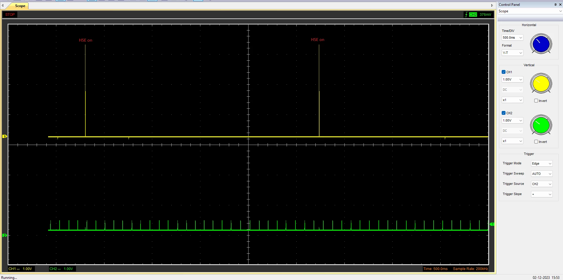

But if I remove the testpin write and add it here:
static void Switch_On_HSI(void)
and here
LL_HSEM_ReleaseLock(HSEM, CFG_HW_ENTRY_STOP_MODE_SEMID, 0);
while(LL_HSEM_1StepLock(HSEM, CFG_HW_RCC_SEMID));
if(LL_RCC_GetSysClkSource() == LL_RCC_SYS_CLKSOURCE_STATUS_HSI)
/* Restore the clock configuration of the application in this user section */
/* USER CODE BEGIN ExitLowPower_1 */
LL_RCC_HSE_Enable( );
__HAL_FLASH_SET_LATENCY(FLASH_LATENCY_1);
while(!LL_RCC_HSE_IsReady( ));
LL_RCC_SetSysClkSource(LL_RCC_SYS_CLKSOURCE_HSE);
while (LL_RCC_GetSysClkSource( ) != LL_RCC_SYS_CLKSOURCE_STATUS_HSE);
/* USER CODE END ExitLowPower_1 */
then I observe, that the HSE is only turned on each 2,4 seconds.

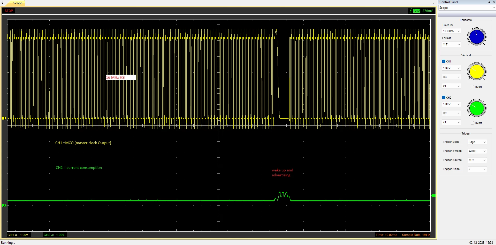

From the readings on the oscilloscope, I cannot confirm that the HSE is turned on each 100 ms, as I would suppose it would be.
Also, when I monitor the MCO output (I output the HSE to a pin), it shows the HSI clock during sleep, but during the advertising there seems to be no clock signal on MCO pin (with prescaler = 16).
Btw. all these measurements are done during debugging.

Kind regards
René

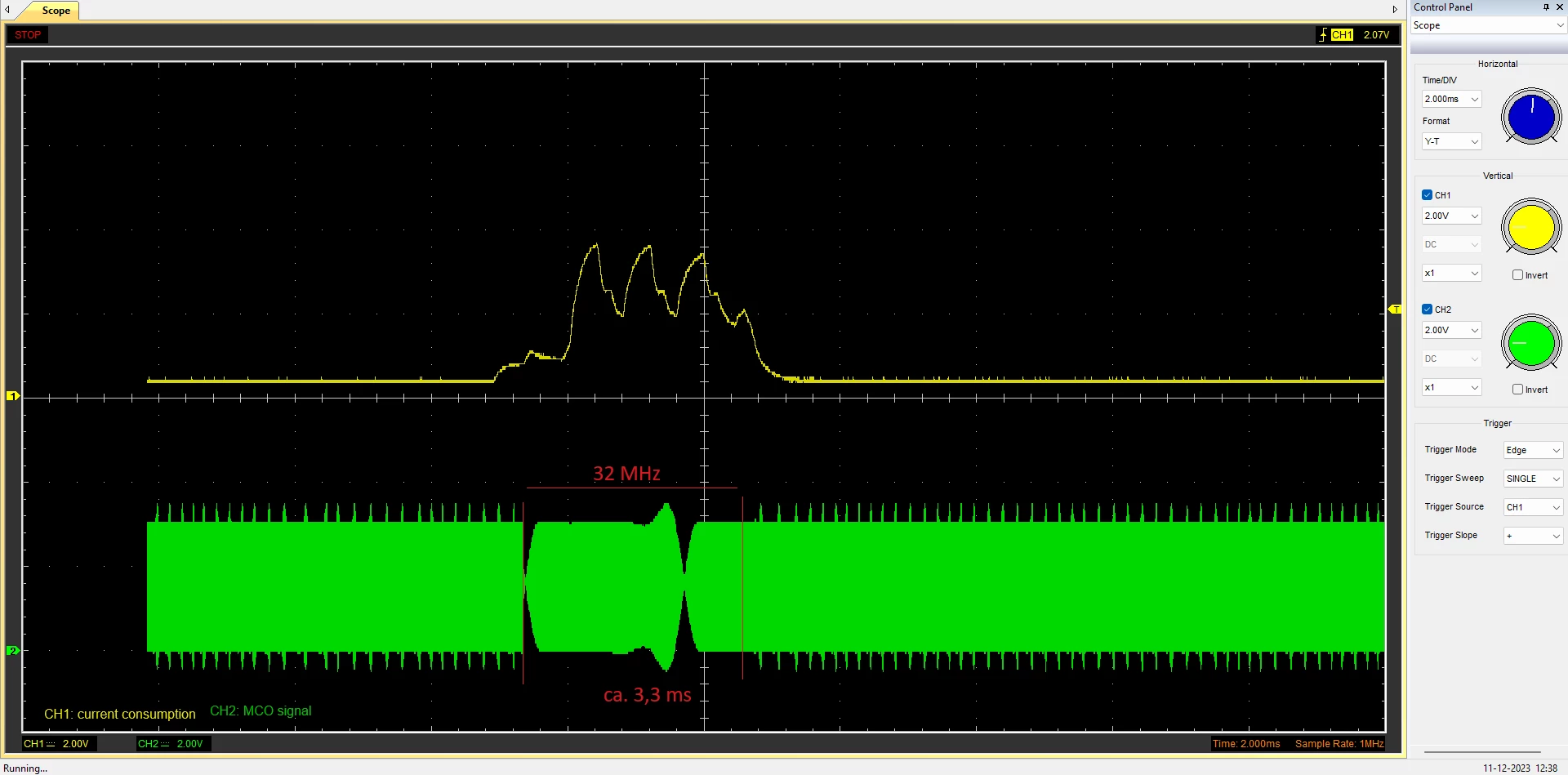

Remy ISSALYS
Dec 7, 2023 4:25 PM UTC
On STM32WB in BLE example, depending on low power mode used, HSE clock is disable or not. In sleep mode, HSE clock still enable and in stop mode and deeper mode, HSE clock is disable.
During advertising, CPU1 has nothing to do, CPU1 is in CSTOP, only CPU2 wakes up to manage the advertising.
When debugger is enabled, DBG_SLEEP and DBG_STOP bits of DBGMCU_CR register are set. When DBG_STOP bit is set: "Automatic clock stop disabled. All active clocks and oscillators continue to run during STOP mode, allowing full CPU1 debug capability. On exit from STOP mode, the clock settings are set to the STOP mode exit state."
In your case, you can disable the debugger and output HSE clock on MCO to see the right behavior.
Best Regards

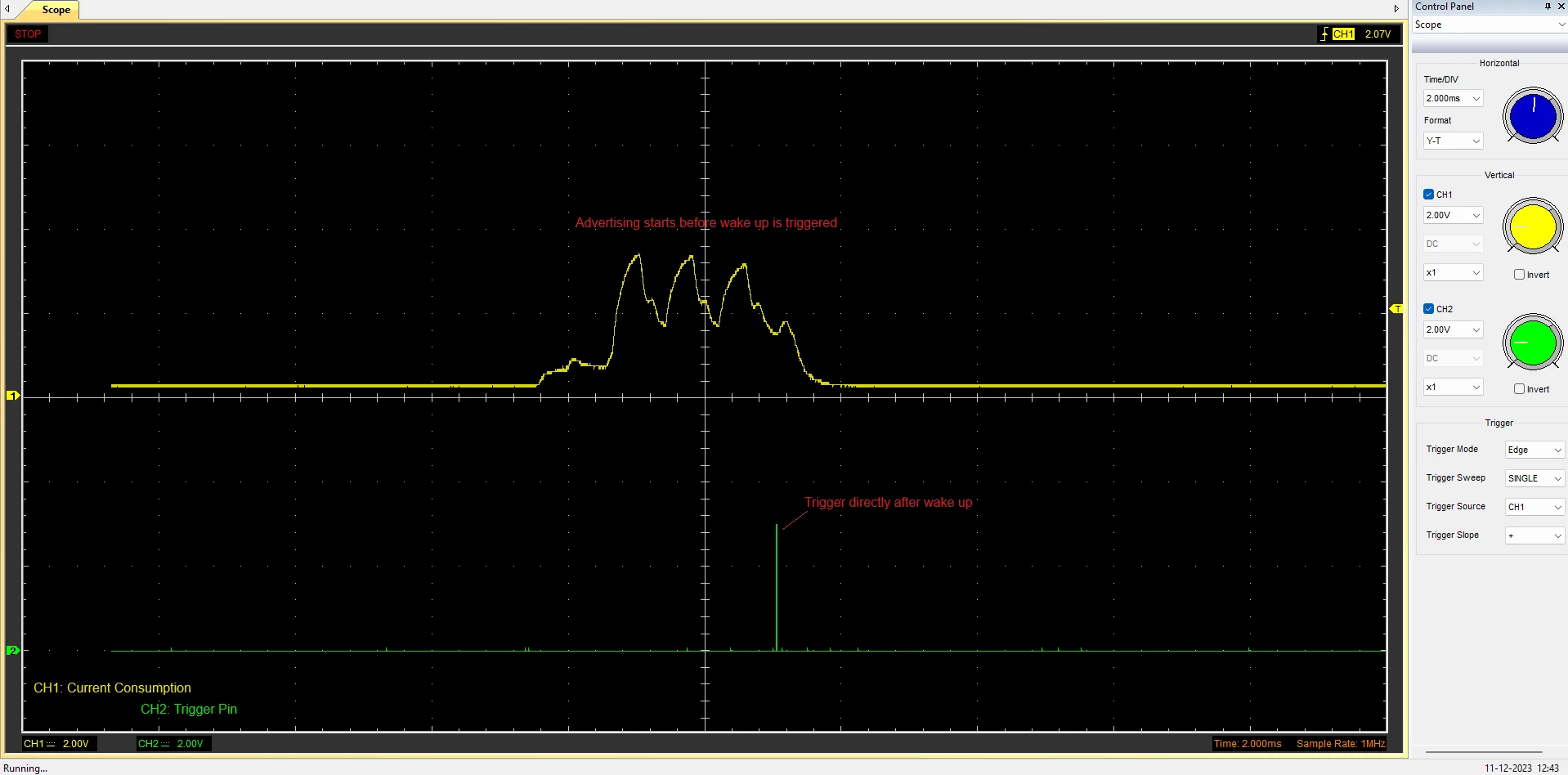

Ok, I did some more testing.
I think I observed that the HSE is activated before CPU1 wakes up from sleep mode.
CPU1 does wake up from sleep mode after advertising.
I set a test pin (LED_FLASH) high and low directly after _WFI(), so I can see when the microcontroller wakes up.
void PWR_EnterStopMode(void)
/* USER CODE BEGIN PWR_EnterStopMode_1 */
/* USER CODE END PWR_EnterStopMode_1 */
 * When HAL_DBGMCU_EnableDBGStopMode() is called to keep the debugger active in Stop Mode,
 * the systick shall be disabled otherwise the cpu may crash when moving out from stop mode
 * When in production, the HAL_DBGMCU_EnableDBGStopMode() is not called so that the device can reach best power consumption
 * However, the systick should be disabled anyway to avoid the case when it is about to expire at the same time the device enters
 * stop mode (this will abort the Stop Mode entry).
 HAL_SuspendTick();
 EnterLowPower();
 * ENTER STOP MODE
 LL_PWR_SetPowerMode(LL_PWR_MODE_STOP2);
 LL_LPM_EnableDeepSleep(); /**< Set SLEEPDEEP bit of Cortex System Control Register */
 * This option is used to ensure that store operations are completed
#if defined (__CC_ARM)
 __force_stores();
#endif
// LED_FLASH_GPIO_Port->BRR = (uint32_t)LED_FLASH_Pin;
 __WFI();
/* USER CODE BEGIN PWR_EnterStopMode_2 */
 LED_FLASH_GPIO_Port->BSRR = (uint32_t)LED_FLASH_Pin;
 	 for(uint32_t i; i<32; i++)
 		 __asm__("nop");
/* USER CODE END PWR_EnterStopMode_2 */
 return;
I also measured the current consumption, so I can see when the microcontroller is advertising.
Interesting to see is that the microcontroller seems to stars advertising before CPU1 wakes up.

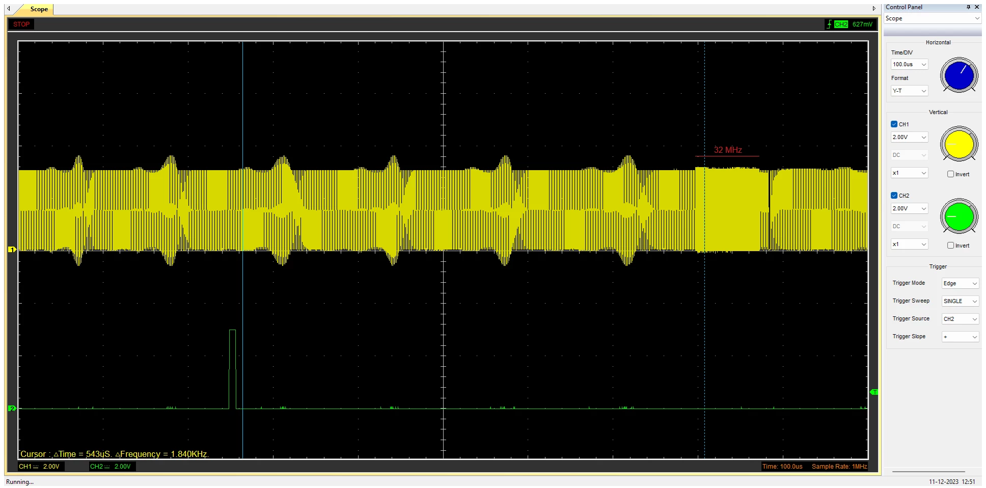

I also connected CH1 to the MCO to observe the clock change:
How does it do that? I thought the HSE is "actuated" by the CPU1? Here we clearly see, that the HSE is running before CPU1 wakes up, which confirms my findings from previous posts.
If I wake up the microcontroller with a timer task, then it first wakes up and then starts the HSE:
RWeil.2
RWeil.2Author
Dec 11, 2023 12:12 PM UTC
Would someone please confirm my findings?
Why is the wake up handler for CPU1 triggered after all, when CPU2 can do the advertising (and activation of HSE) by itself?
