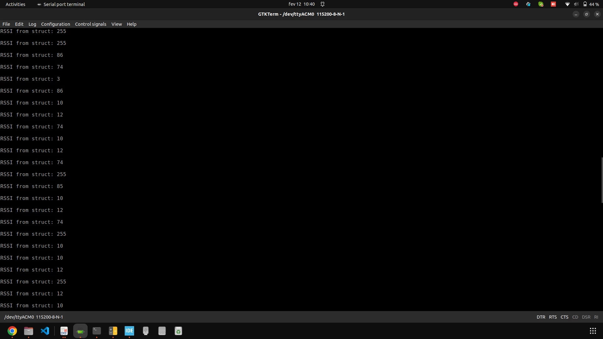

Hello, I am working with STM32WBA52CG as a central and I want to read the RSSI from the incoming advertising packets. The RSSI value should be a negative value in dBm, however it is defined as uint8_t in the AdvertisingReport_t structure. Can someone explain me how to get the correct RSSI value? I am getting the values shown on the terminal below.

 uint8_t rssi = p_adv_report->Advertising_Report[0].RSSI;
 LOG_INFO_APP("RSSI from struct: %d , ", rssi);
 /* USER CODE END HCI_EVT_LE_ADVERTISING_REPORT */
 break; /* HCI_LE_ADVERTISING_REPORT_SUBEVT_CODE */

If it is just a byte, a value such as 74 does not make sense. As per chip documentation there is no clear information about this RSSI value interpretation.
