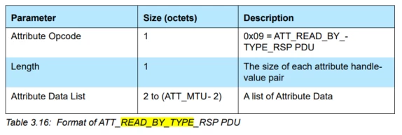

The ACI_ATT_READ_BY_TYPE_RESP_EVENT event contains the handles and values of the attributes that have been read and has the following structure:
0693W00000LxaJGQAZ.pngThe length (e.g Handle_Value_Pair_Length) corresponds to the size of each element of the attribute data list (e.g Handle_Value_Pair_Data).
Each element of the list have the following structure:
0693W00000LxaLbQAJ.pngFor example for Generic Access Service, we have the following values:
Handle_Value_Pair_Length = 7
Handle_Value_Pair_Data =
[0x06,0x00,0x0A,0x07,0x00,0x00,0x2A,0x08,0x00,0x02,0x09,0x00,0x01,0x2A,0x0A,0x00,0x02,0x0B,0x00,0x04,0x2A]
Interpretation of these data:
> Characteristic 1:
0x0006 : Characteristic handle
0x0A : Characteristic properties => Read,Write
0x0007 : Characteristic value handle
0x2A00 : Characteristic UUID => Device Name
> Characteristic 2:
0x0008 : Characteristic handle
0x02 : Characteristic properties => Read
0x0009 : Characteristic value handle
0x2A01 : Characteristic UUID => Appearance
> Characteristic 3:
0x000A : Characteristic handle
0x000B : Characteristic value handle
0x2A04 : Characteristic UUID => Peripheral Preferred Connection Parameters
