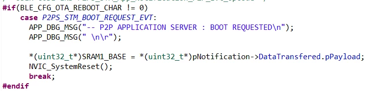

The following is missed that's why the reboot request(in app.c) is not handled and OTA service cannot be triggered.
