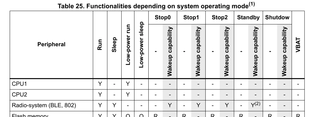

BLE Operation in Low Power Modes on STM32WB
I'm not sure if I fully understand how the low-power mode works with active BLE on the STM32WB. I have an application using FreeRTOS and the BLE stack. I have set up advertising and am able to send and receive data over BLE. This works fine. When CPU1 enters Sleep mode — since it has no tasks to handle — BLE seems to work correctly. However, if it enters STOP2 mode instead of Sleep, it stops working properly.
Questions:
1) If I have BLE advertising set with a period of around 100 ms, can I put CPU1 into STOP(2) mode? Will CPU2 and the radio handle the operations on their own while CPU1 is in STOP mode? If so, will they wake up CPU1 as well?
2) If someone has already connected to my device via BLE, can I also put CPU1 into STOP mode?
3) To entering STOP mode I use funcion from example - hope it is correct?
Some of my research:
In RM0434, it is stated that the system will enter low-power mode only when all three subsystems allow it (CPU1, CPU2, Radio Subsystem). A few lines below, it says that these three subsystems can enter and exit low-power mode on their own (page 154).
At the same time, the table here shows that CPU2 cannot run in STOP mode, but the radio can wake up the entire system if needed.
In AN5289, it is mentioned that the wireless firmware automatically sets the best low-power mode configuration for CPU2 as soon as CPU2 is started.
In the HeartRate Monitor example, `UTIL_LPM_SetOffMode(1 << CFG_LPM_APP, UTIL_LPM_DISABLE);` is called before initializing BLE, and OffMode is enabled again after the initialization is complete.

1) You can put CPU1 into STOP2 mode while BLE advertising. The CPU2 and the radio will handle the BLE operations on their own.
2) If someone has already connected to your device via BLE, you can still put CPU1 into STOP2 mode. The CPU2 will manage the BLE connection and will wake up CPU1 when necessary.
3) You can refer to the PWR examples of the STM32CubeWB V1.20.0 for more details.

Thank you for the response. I probably have a hidden error somewhere, because when I start entering STOP2 mode, BLE starts to malfunction rather than work properly—connecting via BLE becomes nearly impossible. I have advertising set to around 100 ms, but in STOP2 mode, I see the period increase significantly to: 1.5 seconds, 4.56 seconds, and similar values. As far as I know, CPU2 (BLE stack) should handle this timing independently of the state of CPU1? @STTwo-32
