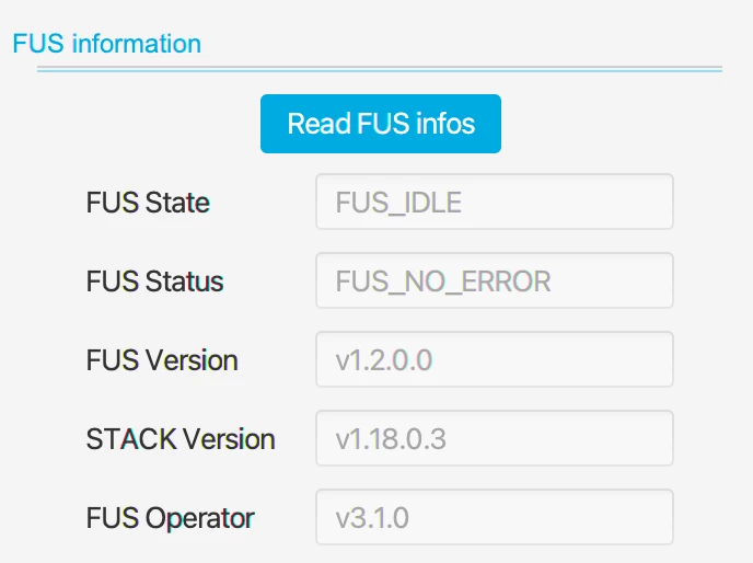

I'm using a Stm32wb5mmgh6tr embbeded MCU for sharing data wireless via BLE. I just saw on the AN5185 application note document that wireless stack is not installed by default. So I've started FUS and then installed the latest version of the WS with STM32CubeProgrammer. After that, I've started the WS:
Spoiler

10:26:51 : Start Wireless Stack command execution finished with success

And I've downloaded BLESensor binary example but it seems that BLE isn't starting since I can't see the BLE device in my phone.

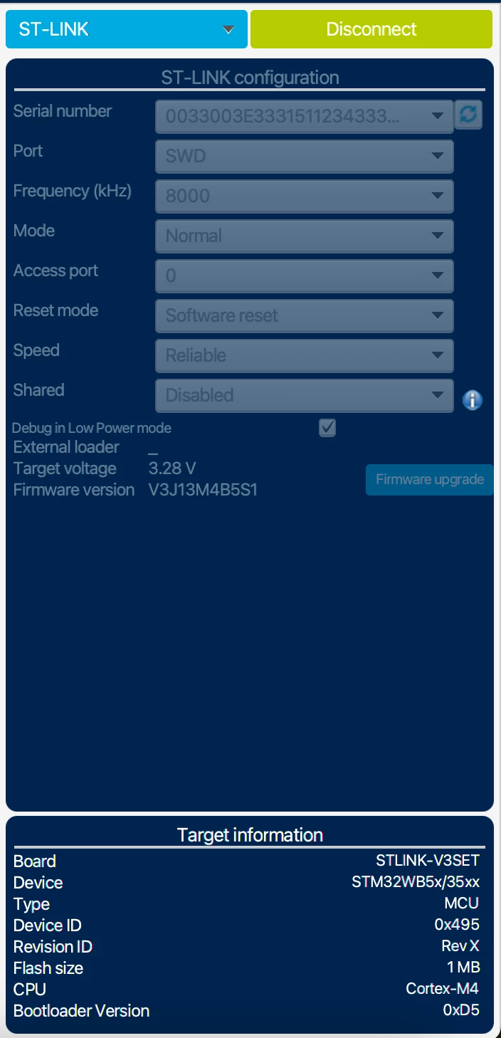

I've checked SBRV Option Bytes value and it's 0x33800, which corresposts to FUS not running. Also I've included here some screenshots of the ST-Link config and FUS version.
Thanks in advance,
