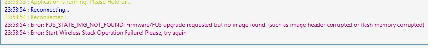

Recently, I’ve been asking several questions about STM32WB55 BLE behavior, and the respected @FilipKremen  has provided me with great support.
It turns out that all this time I was actually working with fake Chinese chips. I suspect that some of the strange issues I faced were due to that.
So, I’ve now bought original STM32WB55RGV6 chips and replaced them in my devices.
However, with exactly the same firmware (which worked fine on the fake chips), the BLE does not start at all.

However, when I set a breakpoint at void APP_BLE_Init(void), the program never reaches that point.
Interestingly, the same kind of project works fine on a NUCLEO board, and I can see the device in the BLE scanner.

probably the FUS firmware is running instead of BLE stack.
Please connect the board to STM32CubeProgrammer and click on the "Start wireless stack" button, then flash the application again.

IlliaGxAuthor
Oct 9, 2025 9:29 PM UTC
I got this on both boards

Oct 20, 2025 10:37 AM UTC
I apologize for late reply, I'm glad it works now.
Regarding the stack version, for getting new v1.22 and higher, the FUS needs to be updated.
Please update STM32CubeProgrammer to the latest version as it removes the previous limitation.
