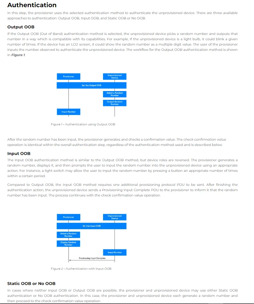

Sep 29, 2022 9:38 AM UTC
BLE MESH Static OOB Authentification connects with NO OOB Authentification
Situatiion:
BLE Mesh Provisioner Example for stm32wb55 nucleo
configuration in mesh_cfg_usr.h:
#define ENABLE_PB_ADV
// #define ENABLE_PB_GATT
// #define ENABLE_PUB_KEY_TYPE_OOB
// #define ENABLE_AUTH_TYPE_NO_OOB
#define ENABLE_AUTH_TYPE_STATIC_OOB
// #define ENABLE_AUTH_TYPE_OUTPUT_OOB
// #define ENABLE_AUTH_TYPE_INPUT_OOB
one unprovisioned Node that should not connect and be able to join the network does not have static OOB enabled but ENABLE_AUTH_TYPE_NO_OOB.
The Provisioining process succeeds without authentification, it chooses no oob authentification although it is not enabled in the provisioner application.
The same problem was found on an esp32 -> https://github.com/espressif/esp-idf/issues/5281
is this wanted, can i disable this no oob authenfication to provision obly me devices?
1 reply
Remy ISSALYS
Oct 5, 2022 12:23 PM UTC
The authentification can be done by BLE if ENABLE_AUTH_TYPE_NO_OOB is defined or by another way "Out Of Band" if ENABLE_AUTH_TYPE_NO_OOB isn't defined. In examples available in STM32CubeWB package, the authentification is done by BLE. See an extract of BT SIG documentation about the authentification:
0693W00000UnPcXQAV.pngBest Regards
