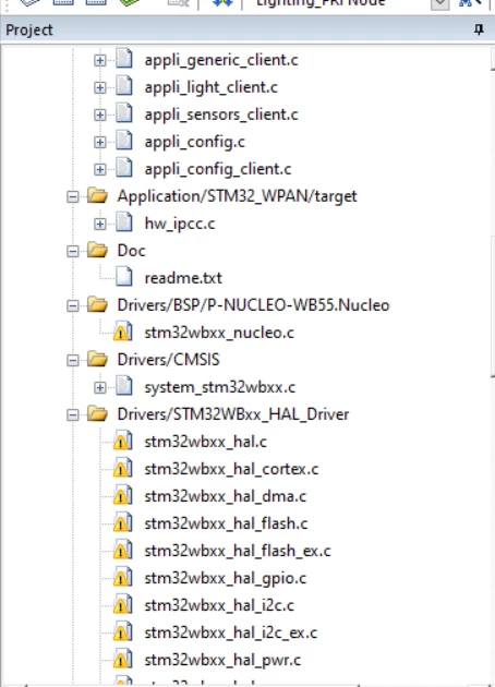

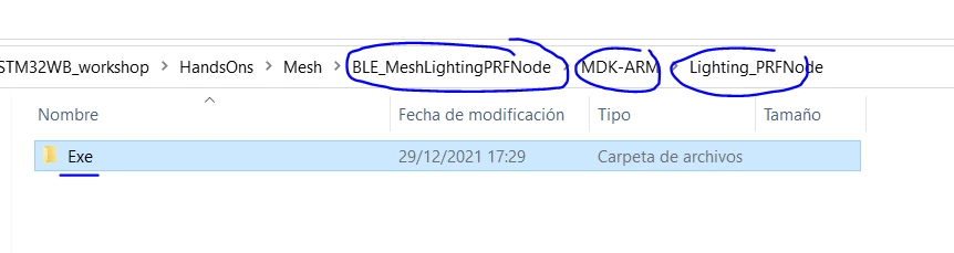

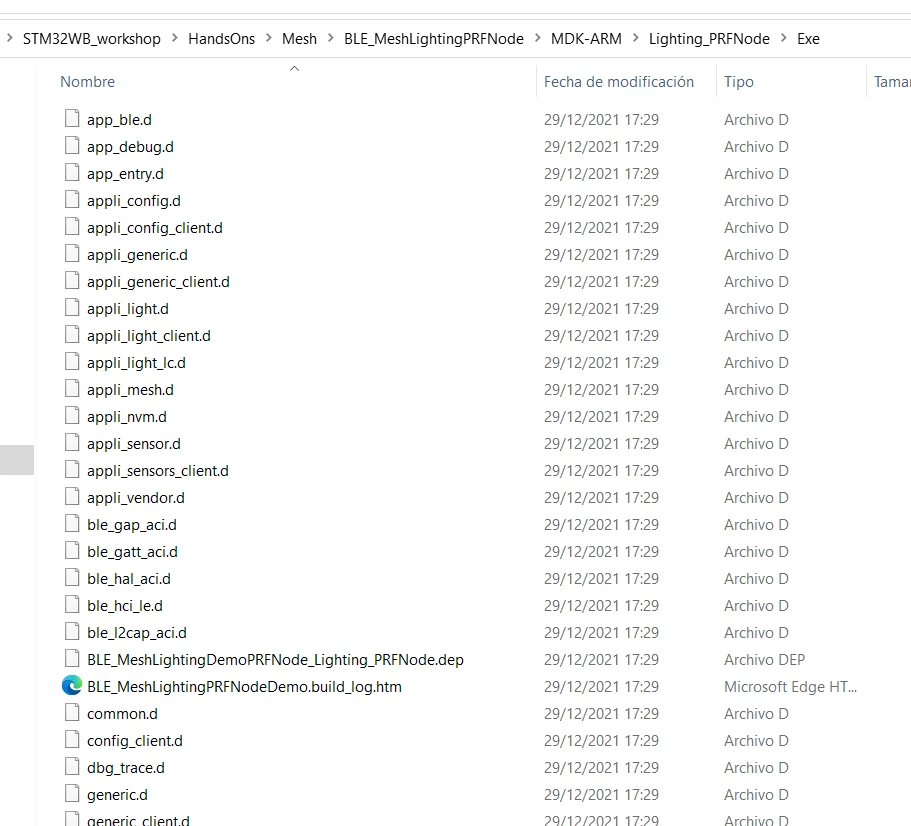

Hi!. I am trying to flash the ble mesh example project from Github in order to modify it and create my own application, but when I have built the project 79 errors where found. I have seen that these errors come from a lot of libraries that are missing. These libraries are in the project, but they are not .c files and they are inside a folder called "Exe" as .d files. Do you Know how can I include this files as .c files in the project?. Thanks for your time.

Please try with the last package available here:
https://www.st.com/en/embedded-software/stm32cubewb.html
