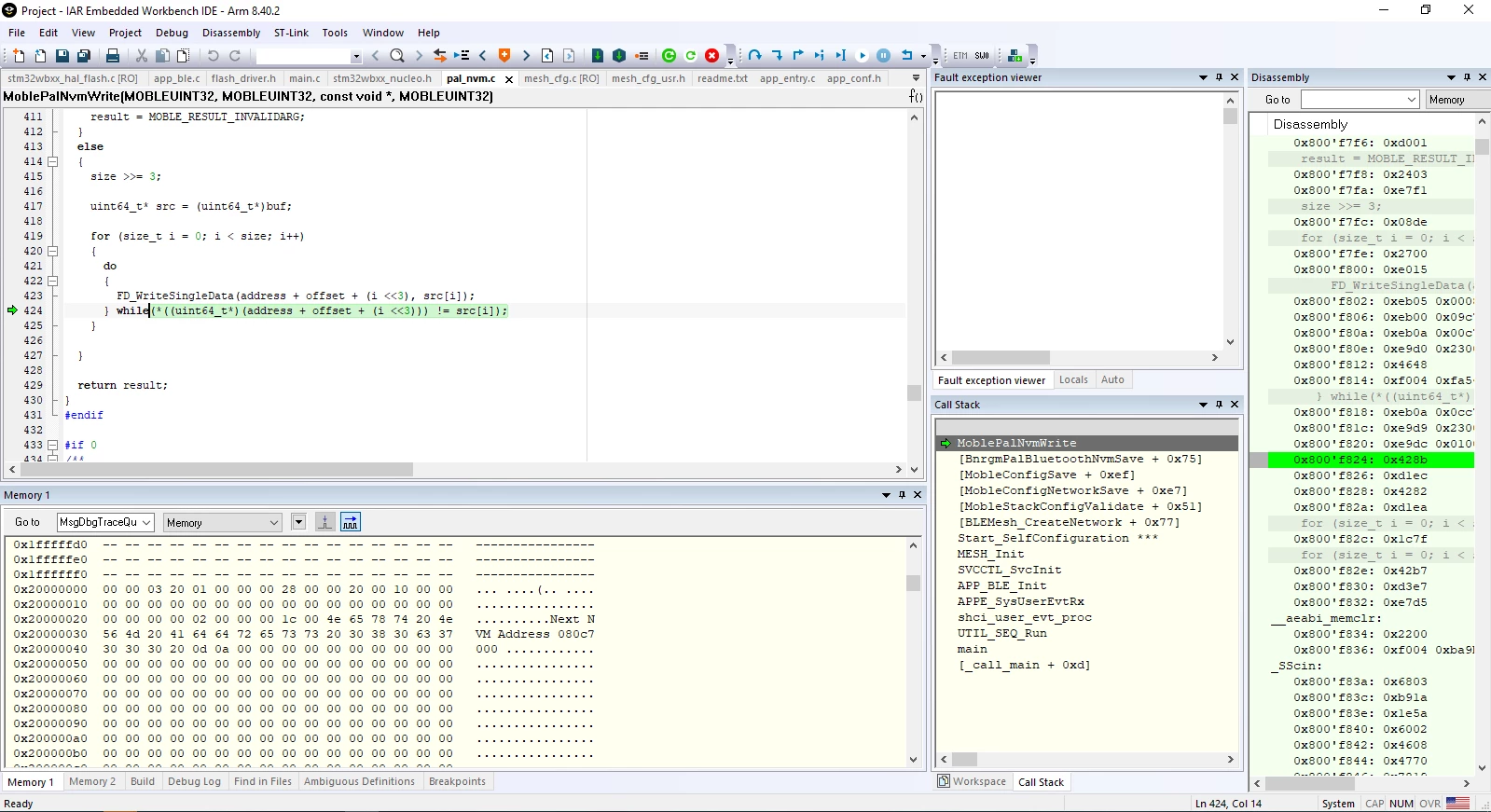

BLE mesh and FLASH access problem
I am trying to develop app based on BLE_MeshLightingProvisioner example.
From the readme file, I know that the node can be self provisioned and configured when the ENABLE_PROVISIONER_FEATURE is defined. This is a great feature and I want to use it.
So I uncommented ENABLE_PROVISIONER_FEATURE define.

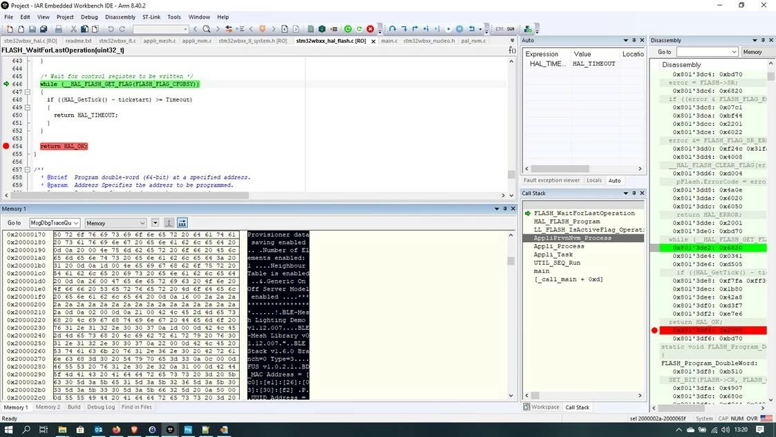

In this example, there is a problem with FLASH access. As can you see on the screenshot AppliPrvnNvm_Process tries to save data but it is always HAL_TIMEOUT.
After more tests I can see when microcontroller is fully cleared (RDP -> 0xBB -> 0xAA) this function works properly and returns HAL_OK.
But after reset there is always HAL_TIMEOUT returned.
The next problem with FLASH access is that I can not write my data to FLASH.
In the cube version 1.6.0 there is provided an example BLE_RfWithFlash with flash_driver.c.
The new flash driver should provide correct synchronization between the two cores during flash access.
I made the following changes based on this example.
Inside my mesh app I change MoblePalNvmWrite and MoblePalNvmErase using functions from flash_driver.c. Please look at the code below.

On the screenshot you can see endless execution do {} while() because of flash write fails.
From this forum I know that there are problems with FLASH access in examples based on BLE. But in mesh write to FLASH does not work at all.
Anyone plays with BLE mesh and deal with this issue?

You cannot set the 2 features ENABLE_PROVISIONER_FEATURE and DYNAMIC_PROVISIONER at the same time.
Perhaps it is not clearly explained in the readme.txt file.
It seems that with the ENABLE_PROVISIONER_FEATURE, some FLASH trouble access happens after each reset of the board, this trouble will be solved in the next releasee.
Nevertheless the BLE_MeshLightingProvisioner project is an example of embedded provisioner, the default configuration settings of this project is the Dynamic provisioner.
In this configuration the FLASH accesses works.
