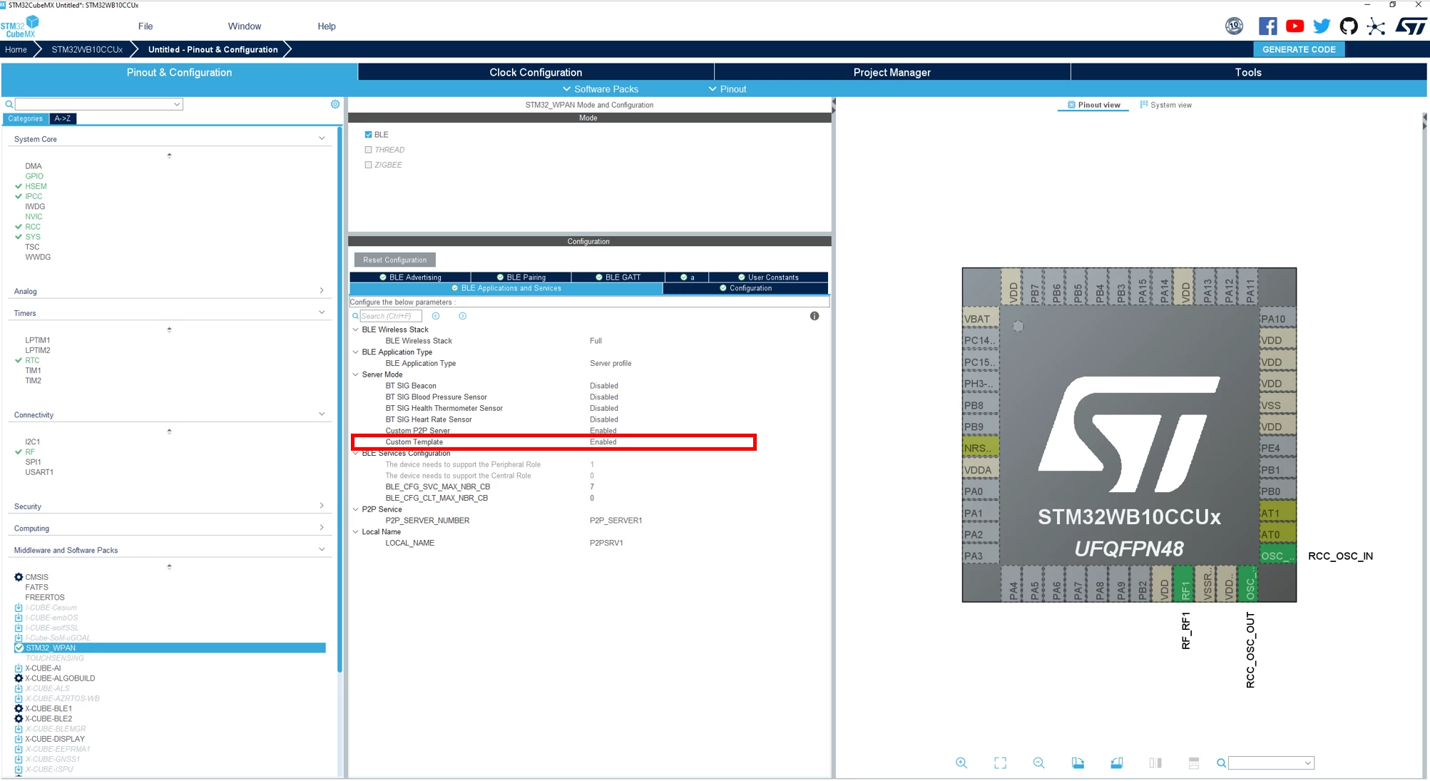

BLE - How to remove the GATT ATTRIBUTE SERVICE
We are working with android and there are multiple problems it is causing us with its Service Changed characteristic.
Is there a way it will not be created? Some chcekbox in CubeMx or else?
Cheers!
1 reply
Ghofrane GSOURI
Jun 12, 2023 2:01 PM UTC
Hello @Community member​

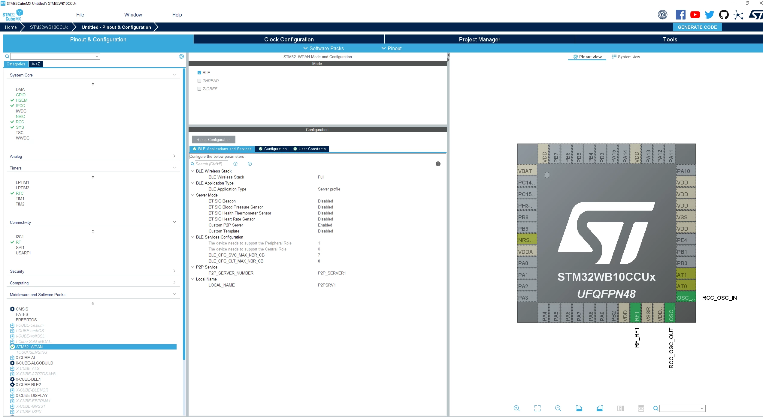

If you want to remove the GATT Attribute Service from your STM32WB device, you can follow these steps:
1- Open your STM32CubeMX project.
2- Disable "Custom Template option "
_legacyfs_online_stmicro_images_0693W00000dDbyyQAC.png3- Save the changes and regenerate the code .
Thx
