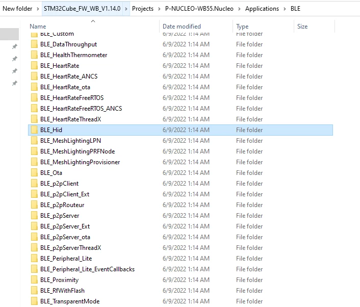

I'm developing a project on chip STM32WB55. I have referenced the demo about
BLE-HID of ST's "STM32Cube_FW_WB_V1.14.0" folder. Base on it, I configured my board become a hid keyboard Bluetooth LE. It worked well on laptop Windows and smartphone Android, Windows and Android can received data from MCU and print them on excel, text file or notepad,... However, on IOS, it can't work as I hope. My MCU still can connect with my Iphone, but my Iphone can't receive data from MCU and after connected I can't forget MCU device on Iphone. Clearly, Bluetooth feature on IOS has somethings difference from Bluetooth feature on Windows and Android. I tried many ways to fix this issue but I still can't find the true way. I hope I can get answers or help from everyone. I will so happy if this happen! Please help me!
This is ST's demo project that I base on it to make my project:
1 reply
