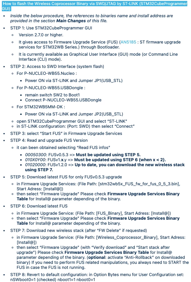

I have managed to compile and upload the BLE_HID example to my Nucleo-WB55RG board, however, I was following the instructions on the readme.txt where it says:
"This application requires having the stm32wb5x_BLE_Stack_full_fw.bin binary flashed on the Wireless Coprocessor.
If it is not the case, you need to use STM32CubeProgrammer to load the appropriate binary.
All available binaries are located under /Projects/STM32_Copro_Wireless_Binaries directory.
Refer to UM2237 to learn how to use/install STM32CubeProgrammer.
Refer to /Projects/STM32_Copro_Wireless_Binaries/ReleaseNote.html for the detailed procedure to change the
Wireless Coprocessor binary. "
Now i thought that was the reason the example was not working so I used the programmer and I think i may have bricked (maybe bricked is not the right word) my wireless co-processor because when i upload the example on a different Nucleo board it works perfect, but on the board that I have used the programmer on, it does not.
In fact, I can't seem to get the BLE to work at all on the original Nucleo board.
What i did:
according to

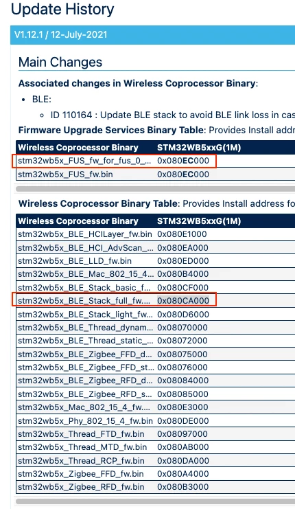

file:///Users/<username>/STM32Cube/Repository/STM32Cube_FW_WB_V1.12.1/Projects/STM32WB_Copro_Wireless_Binaries/STM32WB5x/Release_Notes.html
I followed the instructions: 0693W00000DnehoQAB.pngand used the table:
0693W00000DnehKQAR.pngto upgrade the FW to the right address. but now nothing works.
Any help is appreciated to get the Nucleo board back to its original state :)
