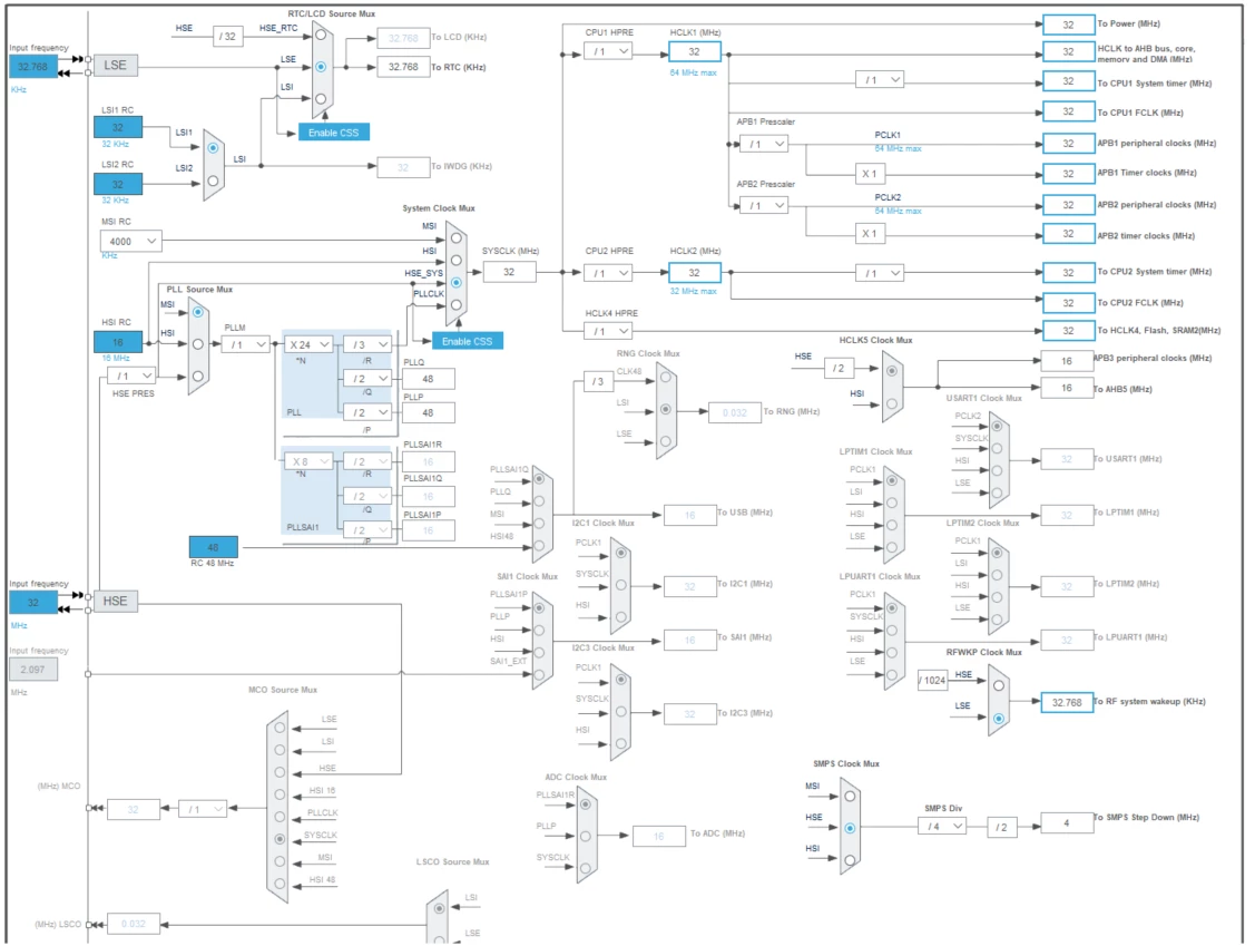

I'm working on a custom board, trying to adapt the BLE_HeartRateFreeRTOS to work on a STM32WB55CEU6. So far i have been able to discover and connect to the MCU and call the characteristics in the Heart Rate service:
  • Body Sensor Location
  • Heart Rate Control point
  • As well as the generic and device services.
I can see the MCU does receive the HRS_NOTIFICATION_ENABLED/DISABLED notifications, as I'm able to toggle an LED in this callback. It seems like the HW-timer does not run properly. NOTE: the MCU does not crash, it just doesn't notify the client.
Setup:
  • MCU: STM32WB55CEU6
  • Code generated with CubeMX 6.2.1
  • Toolchain: Makefile
Relevant code:
Below is the void HRS_Notification(HRS_App_Notification_evt_t *pNotification) implementation:

Clock config (sorry for poor resolution):

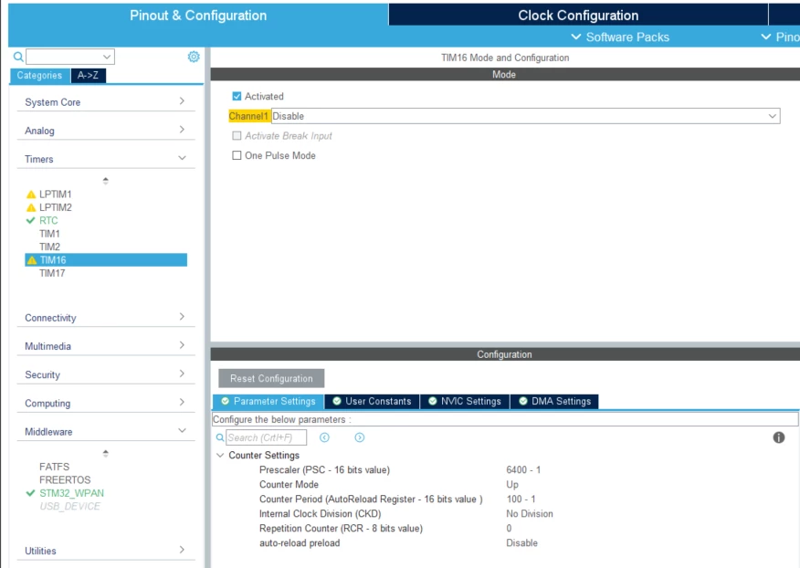

I've done some digging around on in the forum. It seems the Hardware timers is a viable substitute for the Hardware-Time-server - My application is not using all of them.
I'm getting the results a want with (periodic notify that updates a characteristic):
Logic:

Timer configuration:
0693W00000Bbf6IQAR.png+ TIM16 --> NVIC Settings --> Enable interupt

After watching the workshops (from 2019) again, https://www.youtube.com/watch?v=zNfIGh30kSs & https://www.youtube.com/watch?v=tPqHUqiWsvs, I think this could be related to the LSE and RF-wakeup? Though I'm pretty sure my custom board is build according to the recomendations given by ST.

  • I have NOT implemented 'Config_HSE()' in main.c as i have not calibrated the Crystal - I assumed it is not needed as I'm able to pair with the MCU from smartphone.

In order to check if there's an issue with the clock, could you configure the MCO pin to output the clock and view it in a scope. If there's a perturbation it should be (after some looking around) visible there.
Logic:
