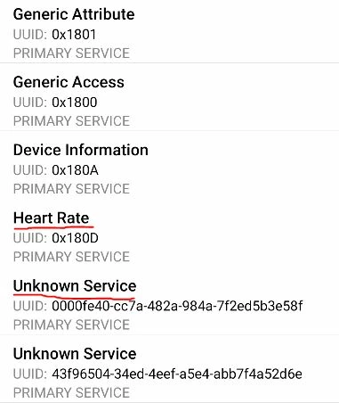

BLE_HeartRate Unknown service
Hello again,
I'm using STM32WB, the name and the image of HeartRate service is visible on my mobile device but I can't set the name and the image for my own service which I create it Why?

When I create my own service I can't set the name for it Why?

The ST BLE Toolbox app, like any other generic BLE monitoring app, parses the services and characteristics based on Universally Unique Identifiers (UUID) which companies have to pay to get it registered with BLE Sig. So unless your custom service UUID is registered with them the BLE app has no idea what that service is. As you know there is not "string" name associated with your service just a UUID. This is why it will always show up as unknown, unless you make a custom BLE phone app that is aware of your UUIDs.
