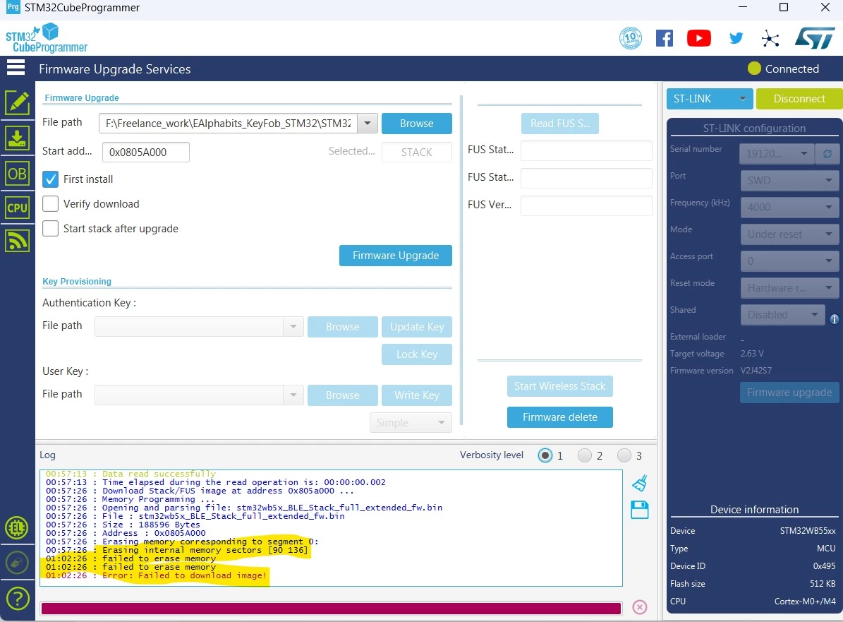

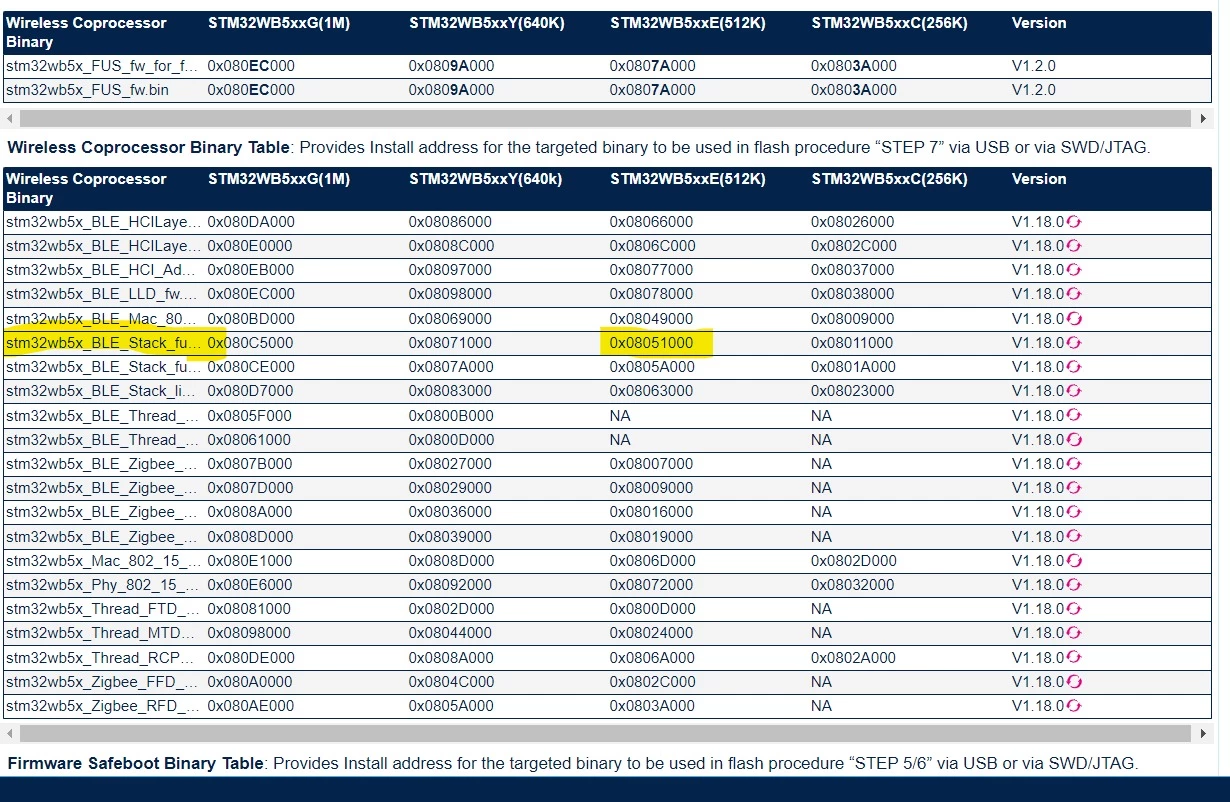

I used following link for reference and follow all steps. Also used "stm32wb5x_BLE_Stack_full_extended_fw.bin" file and address "0x08051000".
https://wiki.st.com/stm32mcu/wiki/Connectivity:STM32WB_BLE_Hardware_Setup

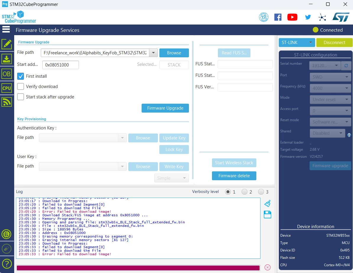

I tried to flash the BLE stack firmware multiple times but not worked in my case. It every time throw error message of erase/write operation failed.

According to your second screenshot, you tried to flash the wireless stack at 0x0805A000 instead of 0x08051000 as mentioned in the release note. Can you retry with the right address?

January 3, 2024
Hi @Remy ISSALYS ,
I tried to flash the wireless stack at 0x08051000 as mentioned in the release note. Still receive the same error in flashing. Please suggest the steps to make BLE working on my board.
Thanks,
SJain

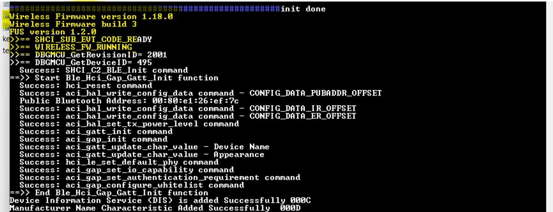

SjainAuthor
January 4, 2024
@Remy ISSALYS Thank you for the steps.
Now BLE working on my custom board after flashing the firmware.
Now only one issue I face that sometimes BLE advertisement not started.
when I debug the issue at that time I found that sometimes instead of WIRELESS_FW_RUNNING event I received FUS_FW_RUNNING event.
Can you please suggest method to receive the WIRELESS_FW_RUNNING state every time ?

You can configure the states from you main Firmware by using SHCI commands. SHCI_C2_FUS_StartWs restarts to the wireless firmware. Polling SHCI_C2_FUS_GetState two times restarts into FUS(!)
When the wireless firmware receives that command, it responds SHCI_FUS_CMD_NOT_SUPPORTED the first time.
When the wireless firmware receives that command a second time, it reboots the full device with the FUS running on CPU2
Remy ISSALYS
May 21, 2024
If you perform some action with STM32CubeProgrammer to run the FUS on CPU2 like "Start FUS", "Read FUS version", "Delete wireless stack", the FUS will run on CPU2, that's why you see FUS_FW_RUNNING in the ready event. For example, after an upgrade of the wireless stack, if you click on "Read FUS version", you should then click on "Start Wireless stack" to run on Wireless stack on CPU2.
