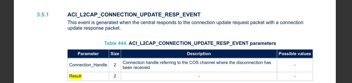

BLE Document waht are possible values of 'Result'
ACI_L2CAP_CONNECTION_UPDATE_RESP_EVENT
What is the Result field?
Need to know if change accepted
Imen.DBest answer
Apr 29, 2024 7:50 PM UTC
Hello @DS.4,
The Result field in the ACI_L2CAP_CONNECTION_UPDATE_RESP_EVENT indicates the response to the request. Here are the possible values for the Result field:
  • 0x0000: Connection Parameters accepted
  • 0x0001: Connection Parameters rejected
