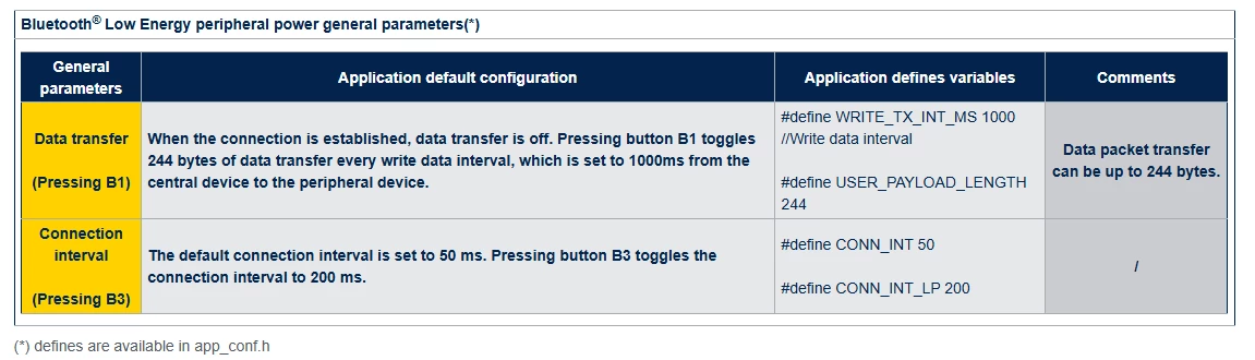

Hello ​@gocchan ,
The default connection interval is defined in app_conf.h.
This ST wiki will help you to define the BLE general parameters: STM32WBA Bluetooth® Low Energy – Power consumption applications - stm32mcu

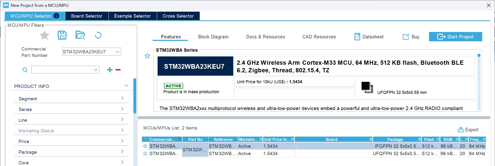

I checked app_conf.h but couldn't find a definition related to the connection interval (I've attached the file).
I also checked the STM32_WPAN file but couldn't find the symbol CONN_INT (I've attached this as well).
The project I'm currently developing was created using CubeMX 6.18.0 with STM32WBA23KEU7 specified in the MCU/MPU Selector. The CubeIDE version is 2.2.0.
