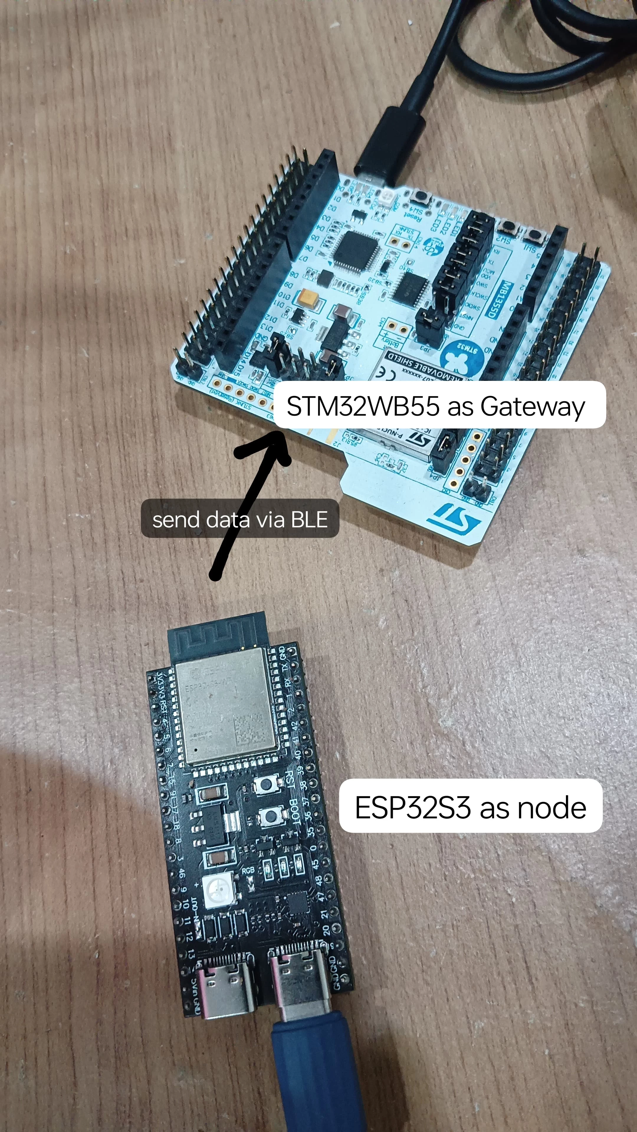

I want to configure a stm32wb55rg as BLE gateway and ESP32 as BLE node such that ESP32 can send data sensor. The  data also needs to be sent to UART or Mobile Phone. Can anyone suggest me a MOOC or may be a document that can  be used as a manual to perform this task.WhatsApp Image 2024-07-22 at 13.38.30_62c3afe0.jpg

As a starting point, I suggest you refer to the BLE_p2pRouteur example for the STM32WB Nucleo board. Then you can try to connect your server nodes (ESP32 or else) to the STM32 Router. Also, you can connect this router to a BLE app on the Smartphone.

thanks mate, but i can't find ESP32 example to be a server to connect my stm BLE_p2pRouteur example
I just found a way to connect with my android device only

There is not such example officially. You have to try to elaborate one by yourself for the ESP side.
