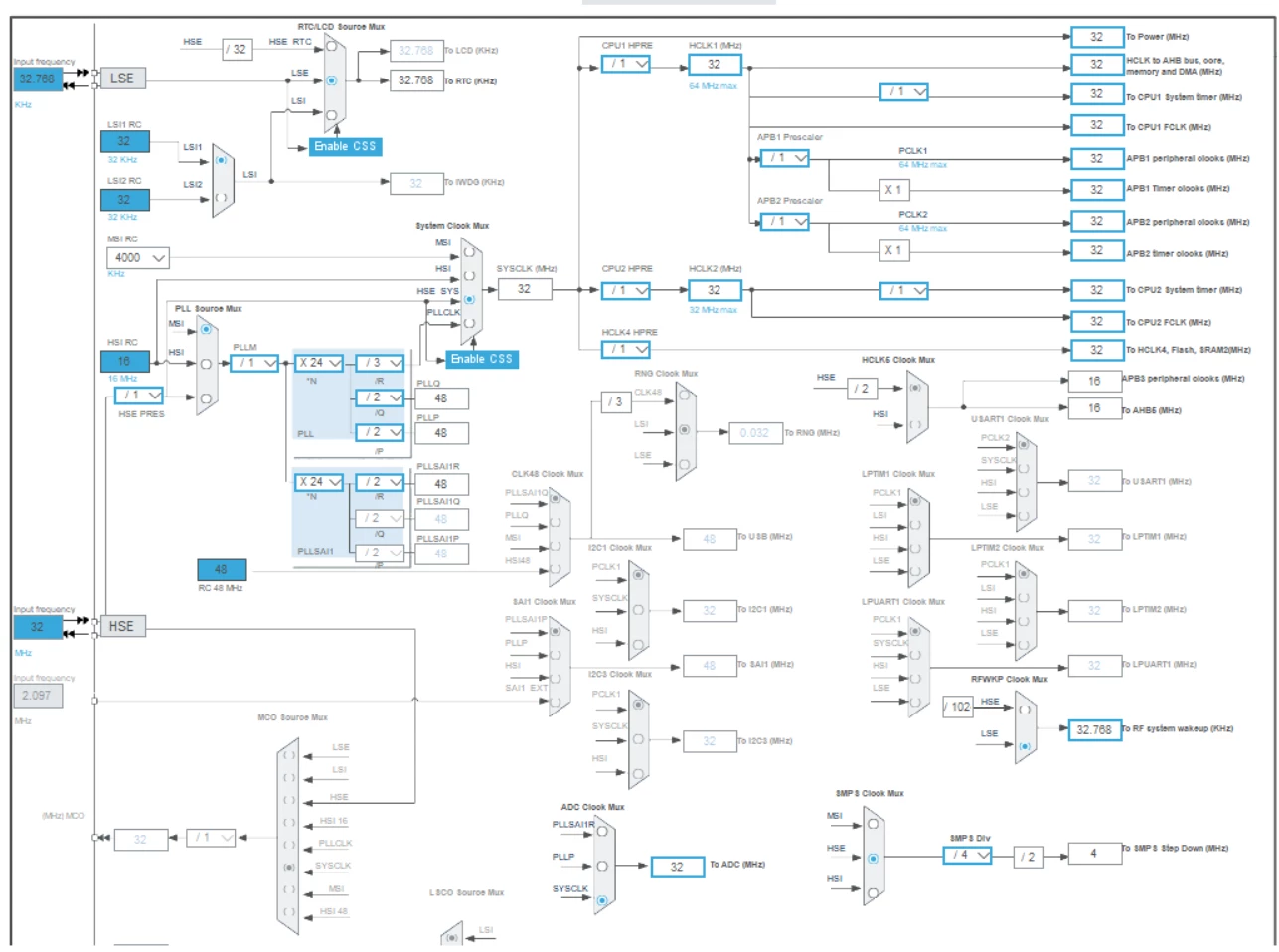

BLE Always Fails when setting RFWKP Clock Mux to LSE
I've been having a lot of trouble getting all of the online BLE examples to work and was hoping someone could steer me in the right direction.  In every example they state that the RFWKP Clock Mux should be set to LSE but whenever I do that the main loops runs once then hangs somewhere in MX_APPE_Process() but I'm not sure where.  Interestingly if I setup a timer and ADC (to give it something else to do) that part works just fine - my ADC loop just reads a few values every second then toggles and LED.
If I set the RFWKP Clock to HSE then it seems to work fine.
I thought it was a problem with my custom board but this happens with the P-NUCLEO-WB55 board as well.
I'm using STM32CubeIDE version 1.14.1 and have the latest version of the FUS and wireless stack installed.

Feb 13, 2024 8:56 PM UTC
I'm basically following the tutorial at https://www.youtube.com/watch?v=Zgw3wRpGSRQ
The only difference is that I'm also adding in some ADC code that's based on a timer - so instead of reading a button the plan is to send it data that comes from and ADC/Timer/DMA source.  I had the same issue without the ADC part so that's not the problem.
In my current code all I'm doing is the ADC stuff and broadcasting two read/notify attributes (that aren't hooked up to events yet).  In the ADC callback I'm flashing the blue light and in main I'm alternating the red and green lights
Below is my clock configuration.  With RFWKP set to LSE the blue light flashes as expected (indicating that the ADC timer is firing) but the red and green lights come on and stay on (indicating that the while only runs once) and no BLE is advertised.  The lights are an easy indication but I can confirm via the debugger that the main while loop only runs once.  If I just change the RFWKP to HSE then everything works fine (blue light flashes, red/green alternate and I can connect to the BLE service)
Here is my main.c code as that's the only file I changed myself (though STM32CubeIDE made it's own changes to other files for RF, etc.).  I'm not sure if there are other files or settings you'd like to see or if it would be easier if I just uploaded a zip of the whole project.

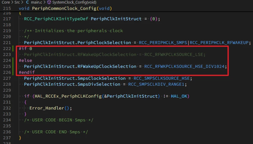

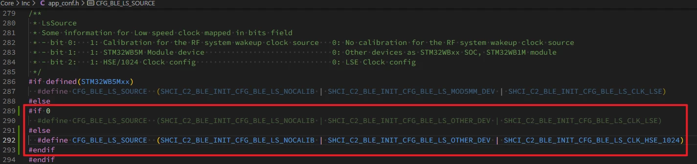

nollsteadAuthor
Feb 15, 2024 2:49 AM UTC
@STTwo-32 I've done a bit more testing and have more information.
1.  As before, when I change RFWKP to LSE it only executes the while once but runs as normal when set to HSE.  Note that this is a custom BLE, not one of the pre-built ones.
2.  I went in and added the additional code from the part 12c video (the sequencer code) and again BLE halts and the main wait only executes once.  This happens when I register my task (myBLENotifyTask) with the sequencer.  If I comment out those two lines in the user code section it works fine:
void APP_BLE_Init(void)
 SHCI_CmdStatus_t status;
#if (RADIO_ACTIVITY_EVENT != 0)
 tBleStatus ret = BLE_STATUS_INVALID_PARAMS;
#endif /* RADIO_ACTIVITY_EVENT != 0 */
 /* USER CODE BEGIN APP_BLE_Init_1 */
 UTIL_SEQ_RegTask(1 << CFG_TASK_MY_BLE_NOTIFY_TASK, UTIL_SEQ_RFU, myBLENotifyTask);
 UTIL_SEQ_SetTask(1 << CFG_TASK_MY_BLE_NOTIFY_TASK, CFG_SCH_PRIO_0);
3.  I used CubeIDE to create a new custom BLE app from the example selector and it had the same behavior.  The code is structured very differently and I haven't found how to test commenting out the sequencer task registration yet but as it was created it halts in while and doesn't run the BLE apps.
So while I'm not sure if the first issue is related (LSE vs. HSE) the second two suggest there is some sort of issue with the sequencer.
nollsteadAuthor
Feb 15, 2024 5:27 AM UTC
Ignore my last comment.  I reflashed both the FUS and BLE stack and the latest problem went away.  Not sure why I had to do that but I've seen a lot of folks mention it in comments so it was worth a shot - a bit concerning but we'll see how that goes.
I'm back to the original problem.  When any app runs with RFWKP clock set to LSE it doesn't work.  When set to HSE it works.
STTwo-32
Feb 16, 2024 10:25 AM UTC
Hello again @nollstead
I can't reproduce this issue. We have a lot of examples that use the LSE as clock source for the RFWKP and everything works fine.
Can you share your project for more details.
Best Regards.
STTwo-32
nollsteadAuthor
Feb 16, 2024 2:52 PM UTC
Sure, attached is a rar archive of a project called Nucleo-WB55.  If there is a different format you need let me know (zip uploads aren't permitted so I used rar).
All it does it grab a few variables via an ADC timer and blink a few lights in that event and in main and exposes a BLE service with 1 characteristic (which I don't do anything with yet).
As uploaded the RFWKP clock is set to LSE and nothing is advertised in BLE.  Setting a breakpoint on the call to MX_APPE_Process shows it only runs once (also confirmed by the green light staying on).
If I just change the RFWKP clock to HSE it works (BLE device called "NUCLEO-WB55 shows up and is connectable and the green light flashes.
nollsteadAuthor
Feb 17, 2024 2:48 AM UTC
@STTwo-32 I've created a new project and (painstakingly) added each feature one by one and now know what causes this behavior - I'm just not sure why or what to do about it.
As I mentioned in my original post, this is a remote control - so it uses a timer to poll the components every 200ms and exposes a BLE service to advertise those.  Each part works fine on its own but when put together I get the issue where the main loop only executes once (and BLE doesn't advertise).
I've narrowed it down to the ADC/Timer combination. That would probably explain why STM's examples that use LSE work - I don't think any of them combine with a timer driving ADC with BLE.
  • When the ADC External Trigger Conversion Source is set to "Regular Conversion Launched by Software" then I can use LSE as the RFWKP clock and BLE is advertised (obviously I don't get any ADC conversions though).
  • When the ADC External Trigger Conversion Source is set to "Timer 2 Trigger Out Event" I have to switch the RFWKP clock to HSE.  It's this combination that causes the problem.
Is this normal?

I have the same problem when run the examples on P-NUCLEO-WB55 MB1355-D01, such as BLE_HeartRate and BLE_p2pServer in STM32Cube\Repository\STM32Cube_FW_WB_V1.16.0\Projects\P-NUCLEO-WB55.Nucleo\Applications\BLE.
I have confirmed that LSE was ready by lSCO pin. After modifing the code ccording to the picture above, both BLE_p2pServer and BLE_HeartRate can work.

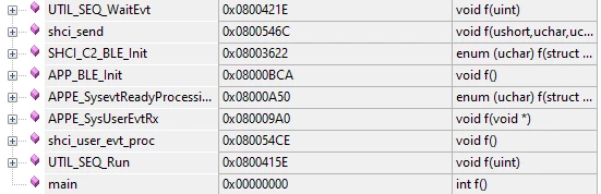

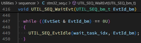

Oct 11, 2024 9:44 AM UTC
Here is the stack when using the LSE as a source clock for the RFWKP Clock.
It trapped in while loop:
