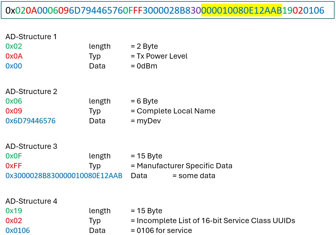

I am currently playing with the NUCLEO-WBA55 board with the BLE_p2pServer_ota example.
During the advertising process, I got this raw data with the BLE scanner on my phone. I mean that the 0x30 is the ID for STMicroelectronics, but what is behind it? Can someone explain to me what 000010080E12AAB is?

Hello @ledi001
The Advertising raw data is well explained on the paragraph 4 of the STM32CubeWBA Bluetooth® LE MCU Package - stm32mcu Wiki page.
Best Regards
