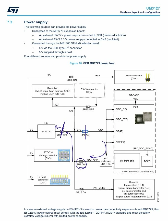

Hi All,
I am working on B-WL5M-SUBG1 hardware.
I compiled the example "C:\...........\STM32Cube\Repository\STM32Cube_FW_WL_V1.3.0\Projects\NUCLEO-WL55JC\Examples\PWR\PWR_STANDBY" to  measure the current consummed in standby mode and I am measuring the current using STLINK_V3PWR.
I removed JP2 and connect "OUT" from STLINK_V3PWR to the pin that supply STM32WL5MOC and the GND of STLINK_V3PWR to GND of STM32WL5MOC.
I got current of about 2.3mA in standby mode instead of  less than 1uA as specified in the datasheet and I discovered that the 5V_PWR LED(LD4 Green) was ON.
I am just wondering how power got to the 5V_PWR LED or if I am missing something, has anyone done this in the past?

We are working with this board too and we realised smth. in power tree:
When we broke SB14, the LED turned off and consumption reduced to 800uA-875uA band (with given configurations above). But you published this post a long time ago. Have you had a chance to further address the issue? If so, we'd appreciate it if you could share it.
