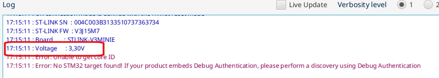

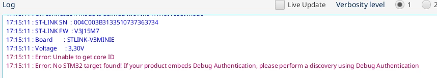

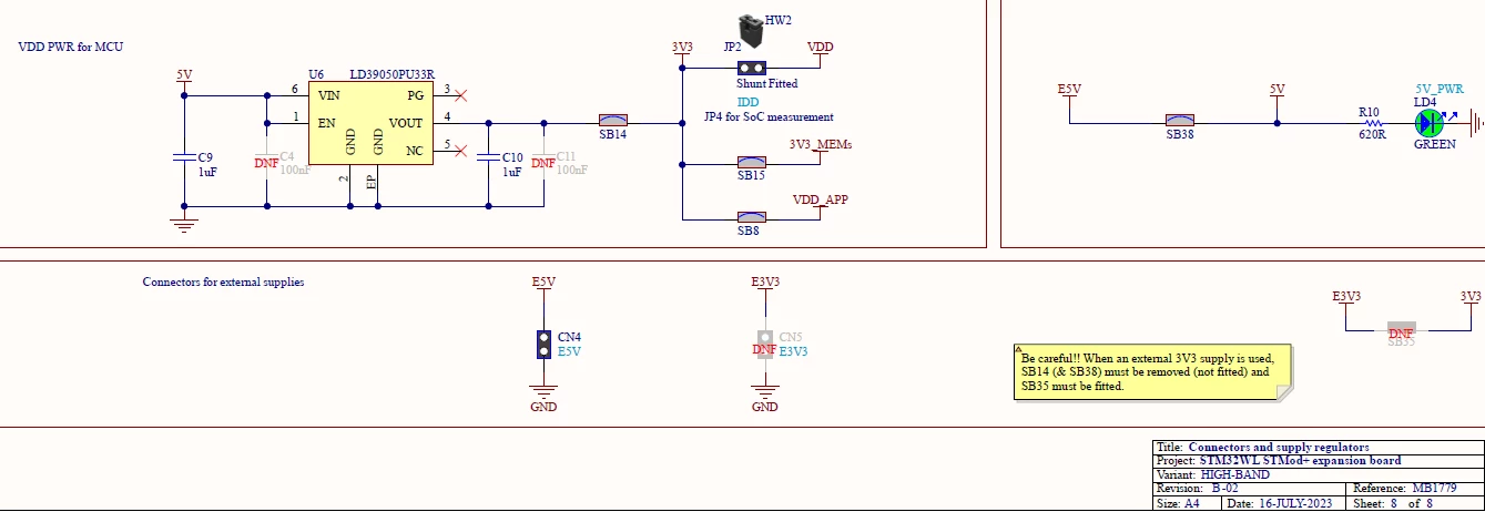

i'm trying to work with Sigfox and MB1779B board.
I try to connect with cube programmer and V3miniE.
here is the log :
is there a procedure to connect to board ?
thank you

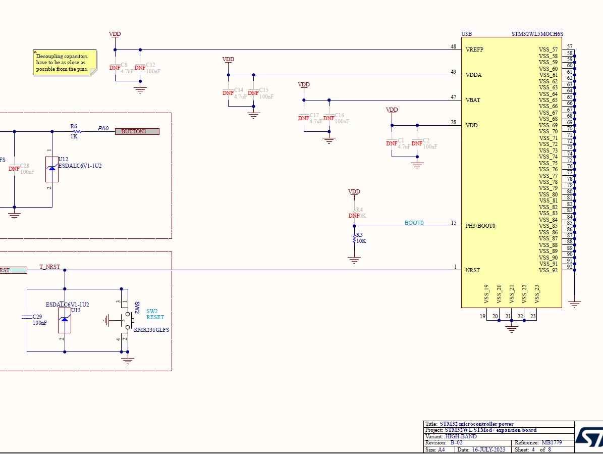

Looks like you have removed JMP2!
If jumper removed, the VDD is disonnected from 3V3 so the STM32WL5MOCH6S has no power!
JMP2 can be used for current measurement.

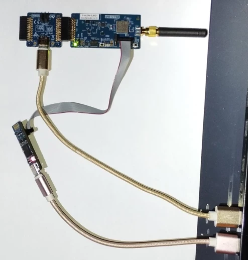

Please show your wiring between the V3miniE and the B-WL5M-SUBG1 (MB1779B).

are you sure you have that ribbon cable the correct way around?
dam74
dam74Author
Feb 12, 2025 6:59 AM UTC
it's a foolproof device, isn't it ?
i'm working with a lsm100A, and it's ok.
thank you, I'm going to check wiring

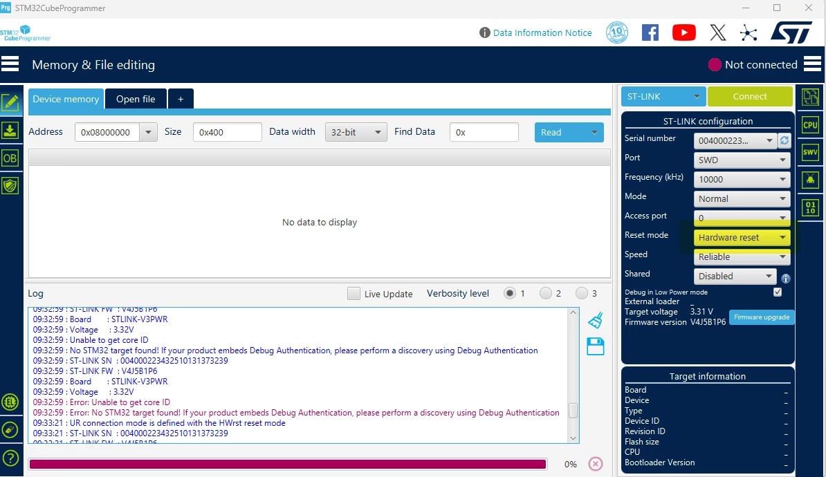

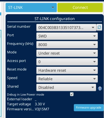

Try using "Hardware reset" - the default setting is "Software reset"
dam74
dam74Author
Feb 12, 2025 9:14 AM UTC
this is my conf :
dam74
dam74Author
Feb 12, 2025 9:16 AM UTC
I've tried differents Modes....

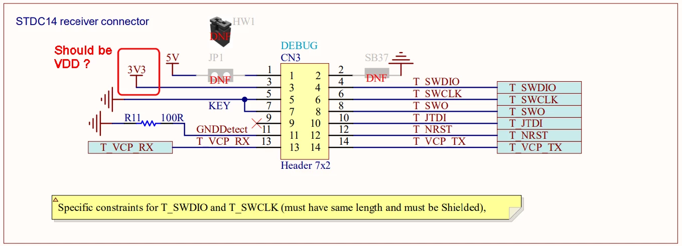

That seems like a really poor design choice on the debug connector:
So the debug probe will report that the target has power - when it doesn't!
As shown in the OP:
