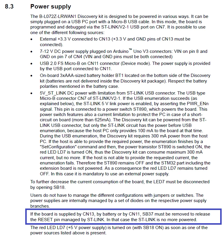

Hello @shorai​,
Based on the description in the "8.3 Power supply" section in the RM2115, I recommend you remove the bridge at SB37.
0693W00000VOW8YQAX.pngDoes the article Cant power B-L072Z-LRWAN1 with battery (st.com) help you?
Please keep me informed about your update on this issue.

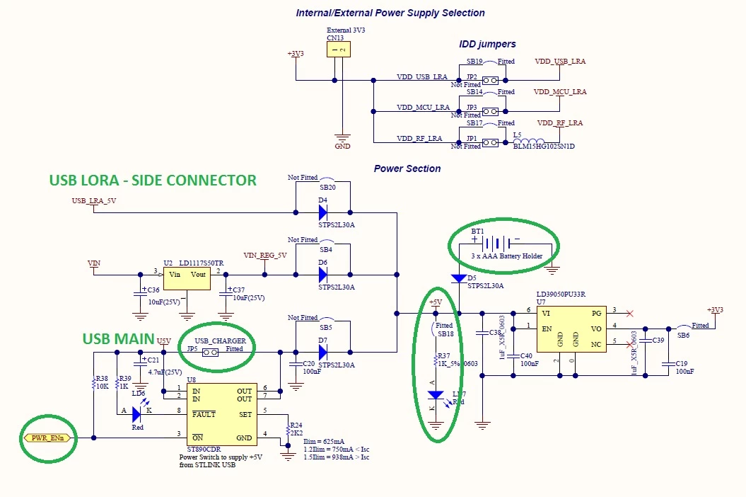

The secondary effect of the primary USB supply being gated is perhaps more frustrating than SB37, which can make it difficult to recover the board.
So many jumpers and solder bridges. It gives flexibility, but needs quite a check list of changes to remind me what to mod. Great power, great responsibility..
The Micro-USB connectors are also a bad choice for these types of boards, just too delicate. Much prefer Mini-USB or USB-C at this point.
0693W00000VOWUAQA5.jpgAnyway, I remove the 3x AAA battery pack, and use those points to connect an AdaFruit battery/charger (one that can do both concurrently) and some 3.7V parallel cells.
Recommend adding a switch in-line, and if current is a big issue lose the LED, but I generally like to see if its 'hot' or not, and I'm basically using the battery as a UPS, and something I can solar charge.

Thank you @Community member​ for an excellent answer and synopsis.
Like you, I find the micro USB connectors inappropriate for this type of board.
Thanks also @KHALSI_Foued​ for reminding me to RTFM. Just looking at the diagram above, on first glnce, it appears that any of the power provisioning methods are equivalent. One has to look elsewhere to find discrepancies. Any reasonable human can fall into this trap. If flexibility is the aim, this circuit does not provide it.
When breadboarding, I much prefer the USB-B as it fits a 2.54mm pitch. Having adapter boards all over the place is a pain, and they need to be sourced. They suffer mechanical damage in this environment
The myriad of jumpers is also quite a minefield.
