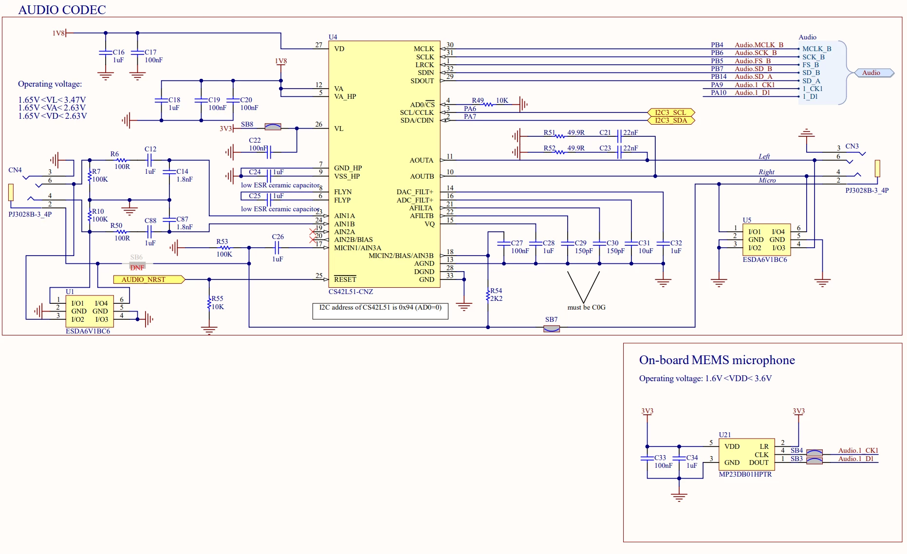

I have started using Nucleo-WBA55CG for BLE Audio and realized STM32Cube_FW_WBA_V1.3.0 does not contain any audio code for the board. But STM32WBA55CG- DK1 has the ble audio snippet code.
Can I use the nucleo board to implement the audio examples since the microcontroller is same?
Thank You in advance.

Hello @Pallavi
This example should be able to run on all STM32WBA55xx. But it has HW depends that are not implemented on the  Nucleo Board Specially the Audio Codec part:
Best Regards.

Hi @STTwo-32
Ok.
So do I have to connect a codec separately? Or what other circuit has to be interfaced on Nucleo to get the audio working?
