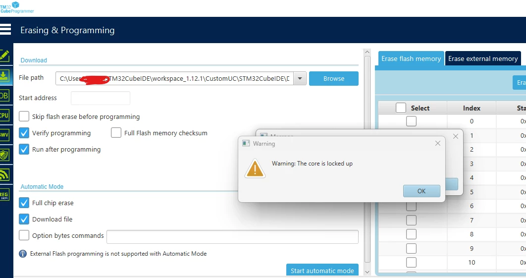

ASTRA1B: Warning after programming: the core is locked up
  • July 31, 2023
  • 4 replies
  • 2797 views
I flashed this firmware on board:
after programming it shows this:
nothing is running.

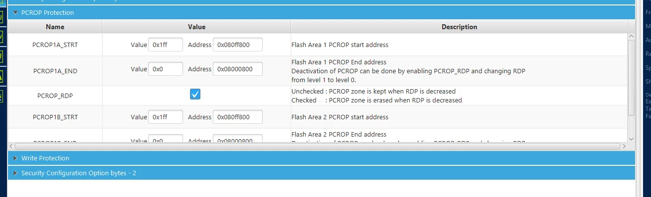

I found some disscussion about PCROP, my settings look like this:
very appreciate any help.

Hello @Danny0007 and welcome to ST Community.
You can take a look to the parts 3.2.24 and 2.4.1 of the UM2237. Those can helpful for the locked core warning.

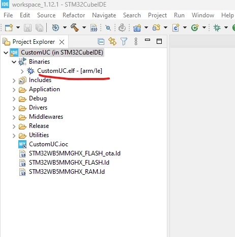

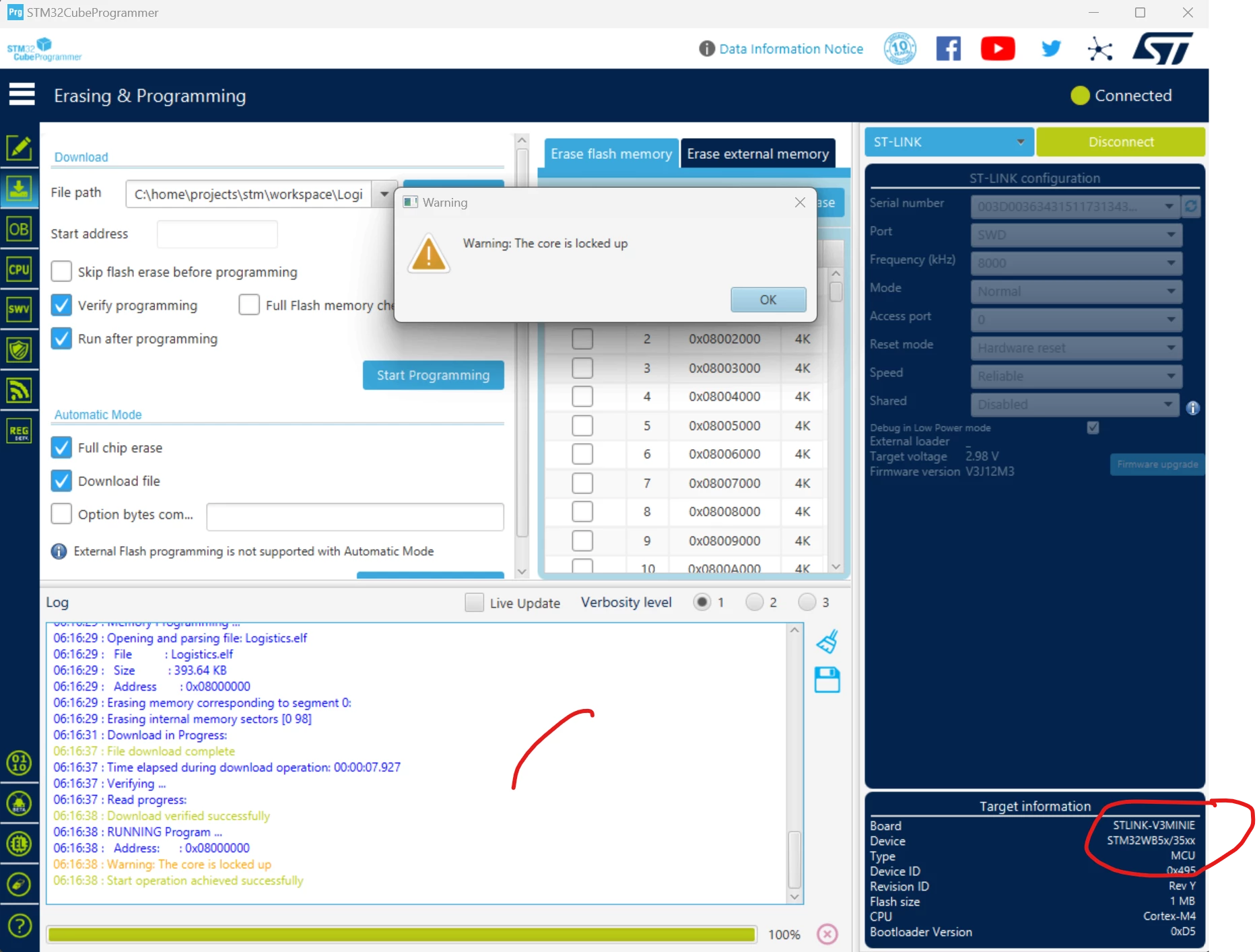

I have a similar problem.
- Astra1b is attached to PC via ST-Link mini.
- Build the debug Logistics application example using CubeIDE.
- Erase the chip's memory using Programmer. Reread it back and it is all FF's.
- Flash the STM32WB on new ASTRA1B board using Programmer.
- Programmer indicates target is WB5x core, and not the WL5x LoRa core.
- Partway through flash the message "core lock up"  appears as depicted below.
- Reread the memory and it looks like the flash worked.
- The  chip does not do anything other than blink a yellow light next to USB connector, which is was doing before flash. No activity on virtual COM port.
- Setup used successfully to flash WL55JC Nucleo board.
Any ideas.
