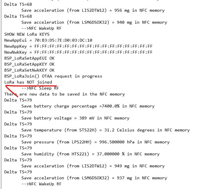

I´m doing my first try with the board STEVAL-ASTRA1B, try to run the example binary for Logistic.
LoRa can not join the network:

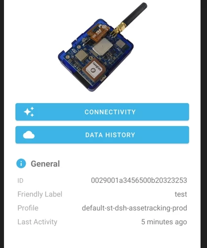

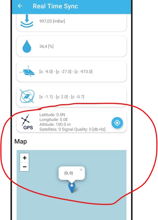

on the APP ST Asset Tracking there is no data from GPS:
some hints? Thanks in advanced.

For the GNSS data display problem, I suggest you to use your device outdoor because GNSS does not work well indoor.

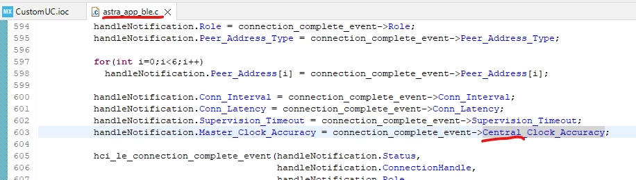

this time I recompiled the CustomUC code by myself, there was an error in :
it was Master_Clock_Accuracy.
After I flash the device with new binary file, it seems working.

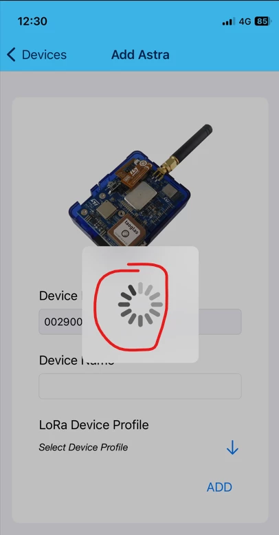

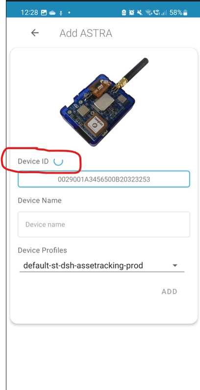

But the mobile app ST Asset tracking hangs, the device can not be added succecssfully.
I tried both android and ios version
Thanks and Best regards
Danny
Nov 8, 2023 9:38 AM UTC
Found a solution in the STM32CubeProgrammer: Instead of pressing download under "Memory & File editing", downloading the exact same files under "Erasing & Programming" made it go from "Ble configuration error, sys will reboot (3)" and "M0PLUS_APP_VERSION: V0.0.0" to functioning state.
