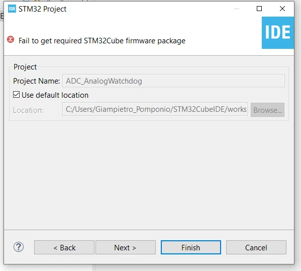

Anyone know how to resolve a "fail to get required stm32cube firmware package" error when importing a new project?

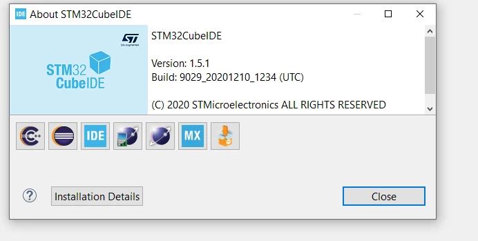

I'm trying to import an example project for STM32WB using STM32CubeIDE V1.5.1
and got the following error:
0693W000007YzafQAC.pngI tried doing package updates, uninstall and reinstall and everything I could think of but I wasn't able to figure out how to resolve this (tried googling/forum searching it but no luck).
Following I report you the Package installed:
How can I resolve this issue?

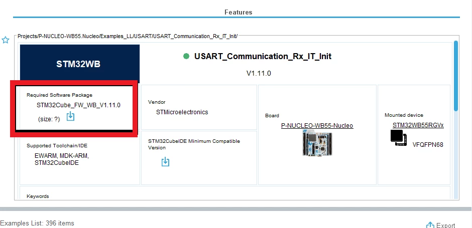

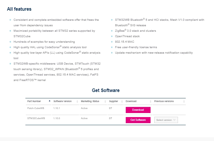

I've done other tests without success.
I've noticed that the required software package is 1.11.0
But the lastest release downloaded from the ST'site or STM32Cube is 1.10.1:
someone has the same problem? Any ideas to solve this problem?
Khouloud ZEMMELI
Feb 22, 2021 3:46 PM UTC
Hi GPomp.1,
Thank you for raising the issue,
You have right, issue is fixed now, please do a Refresh Data to resolve the problem.
We are deeply sorry for any inconvenience this may have caused.
Thanks for your contribution, Khouloud

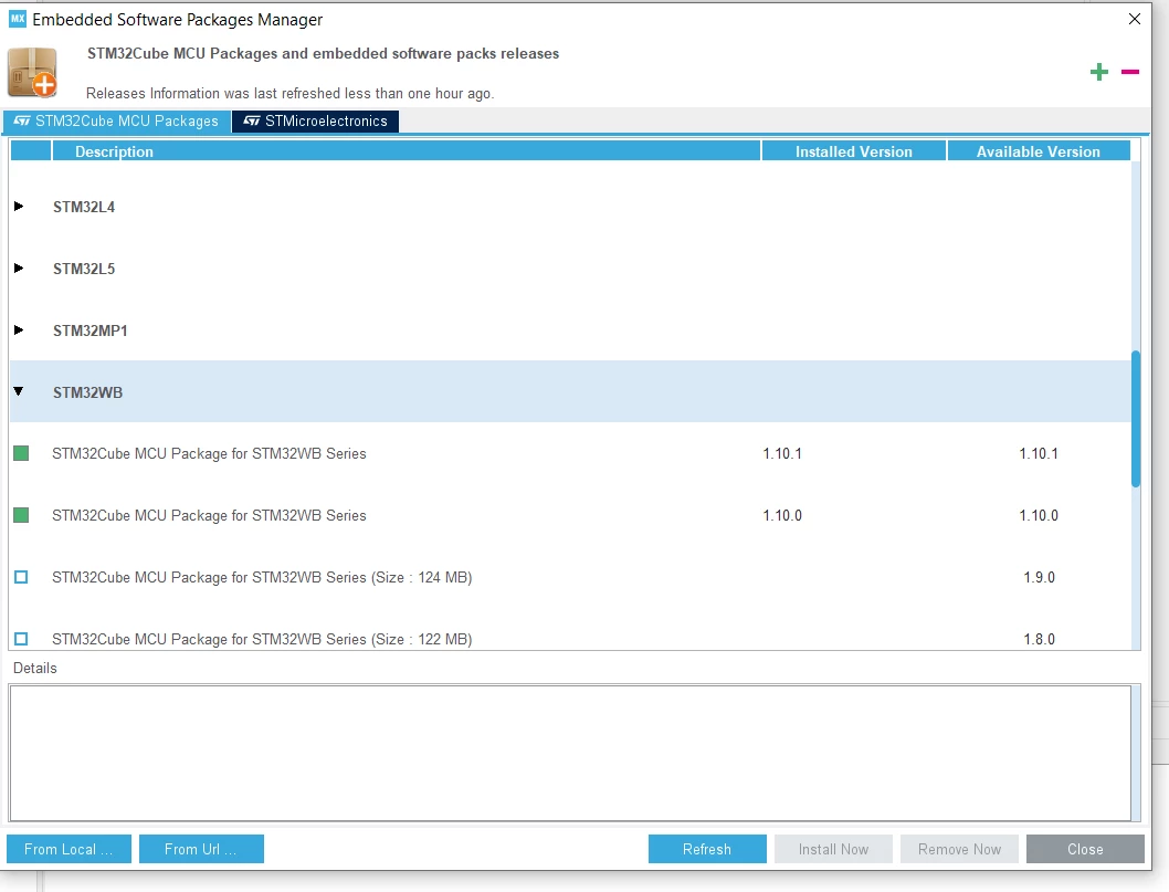

I open STM32CubeIDE and click to Help->Manage Embedded Software Packages.
After I click on the button 'Refresh'. The procedure go on without error (I don't have connection problem) in fact I've seen that the download procedure is done but the last release downloadable for the series STM32WB is 1.10.1 yet.
Is it right the procedure that I've done?
Giampietro
Khouloud ZEMMELI
Feb 22, 2021 4:19 PM UTC
Hi again @Community member​ ,
Yes, everything is ok, the STM32WB 1.11.0 firmware version will be available for the next CubeMX and CubeIDE releases.
Khouloud

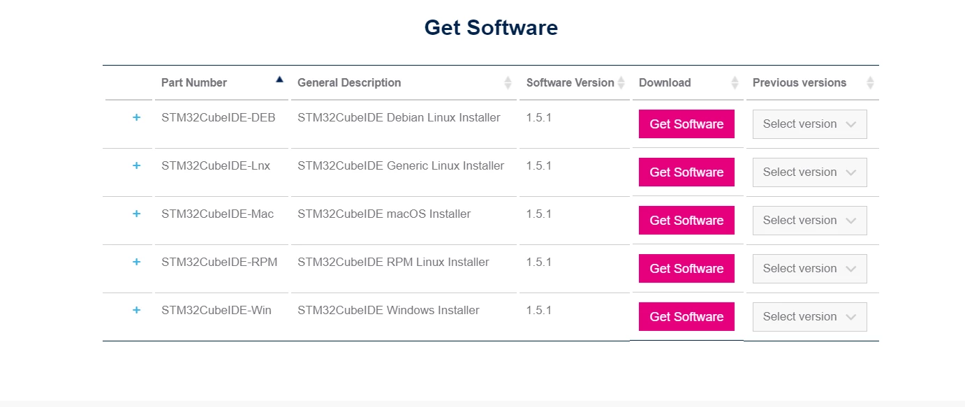

Hi again Khouloud ZEMMELI,
When the new release for CubeIDE is available?
I've now checked the last downloadable is 1.5.1 (my current version) yet.
Giampietro
Khouloud ZEMMELI
Khouloud ZEMMELIBest answer
Feb 23, 2021 9:20 AM UTC
Hello @Community member​ ,
The next CubeIDE and CubeMX releases will be available to download from st.com at the end of this week.
Hope my answers helped you, when your question is answered, please close this topic by choosing Select as Best (the reply that answered your question or solved your problem).This will help other users find that answer faster.
Thanks, Khouloud
