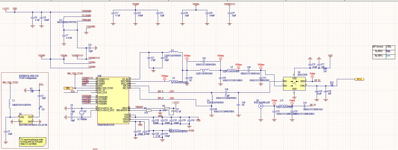

Antenna doesnt transmit in STM32WL55 Generic node based on Lorawan_End_Node
Hi All,
I am working with the STM32WL55 MCU in a project-based between Generic Node and MB1389 (Nucleo board). my code is using Lorawan_End_Node.
Everything seems to be working well but the radio part is not transmitting (checking it with AIRSPY an a SDR device). We can see the LoRaWAN messages debug logs and it tries to connect to the network but no radio at all.
Things we have seen:
  • VDD1V5 is around 2V.
  • PB0_VDD_TCXO is around 0.7V.
I did all the steps from this tutorial:
https://www.youtube.com/watch?v=Gjuu4OOPh1w&t=1477s
the hardware design is
https://github.com/Sosteco/generic-node-se/blob/develop/Hardware/sch/sch-stm32wl.pdf
 Our design main difference is that we are using 32MHz HSE TCXO with 3.3 VDD, we modified TCXO_CTRL_VOLTAGE from TCXO_CTRL_1_7V to TCXO_CTRL_3_0V in radio_conf.h
I checked the voltages in PB0_VDD_TCXO is 0.756 V (always), it must be arround 3.0 V... and VFBSMPS is 1.945v and it must be maximum 1.62 (datasheet).
Firmware shows as it is transmiting properly (i am only testing Phy layer, not Lorawan):

Yevhen
Jun 8, 2023 5:31 PM UTC
@RPaja.1​
hello, did you resolve your problem?
I have the same problem with my custom board.
but voltage VDDRF1V55 = 1.5V
all other 3.3V
and I don't receive any interrupt from the SUBGHZ module and doesn't anything transmit

Yevhen
Jun 9, 2023 10:08 PM UTC
@RPaja.1 check the 32 mhz quartz. My was wrong solder, and after fix it - subghz module is working good

This is one of the first search results for "MAC txTimeout", so I thought I would document my experience and solution.
"MAC txTimeout" is a generic error printed by OnRadioTxTimeout() in Middlewares/Third_Party/LoRaWAN/Mac/LoRaMac.c. It occurs when the SubGHz PHY times out during a transmit. That is, the SubGHz PHY did not notify the application that the transmit was completed (the error does not mean that the transmission failed to be acknowledged by the LoRa gateway). If you're experiencing this error, it's likely that the SubGHz PHY interrupt is not working properly (SUBGHZ->NVIC Settings->Enable interrupt must be ticked; validate that the interrupt is being processed correctly).

  1. As others have noted, the STM32WLE is a special case when you use a crystal oscillator on the HSE32 input - capacitors are built in to the chip, and you must not include your load capacitors for the crystal. This is discussed briefly in the reference manual (RM0453 section 5.4.2) and in AN5042.
    It's critical that the HSE32 32MHz clock be very, very close to 32MHz, because otherwise the LoRa transmit frequency will be wrong and the gateway will ignore you. A spectrum analyser and a near-field probe was useful to measure the clock frequency, and you can adjust the built-in capacitor value by changing XTAL_DEFAULT_CAP_VALUE in LoRaWAN/Target/radio_conf.h (you can also just calculate the correct capacitor values for your crystal in the usual way, and set this variable appropriately if you do not have a near-field probe). Note that this variable is overwritten by STM32CubeIDE when you generate code.
    Alternatively, consider using a TCXO instead of a crystal, as the frequency accuracy matters.
    In the clock configuration, it does not seem to matter which speed or source the SYSCLK runs from (though more accurate is better for timing reasons, see #2 below) as the SubGHz PHY takes its clock directly from HSE32 regardless of SYSCLK.
