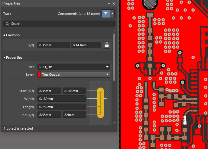

We design the custom board in a 4-Layers stack-up. We also implement impedance matching for RF traces where required.

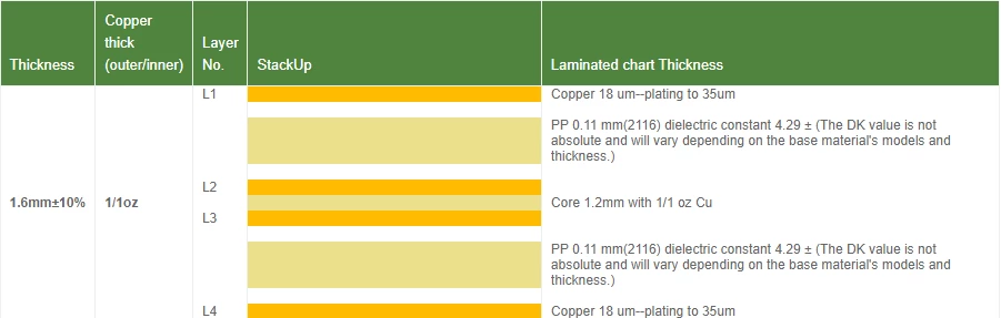

The design Stackup is here:

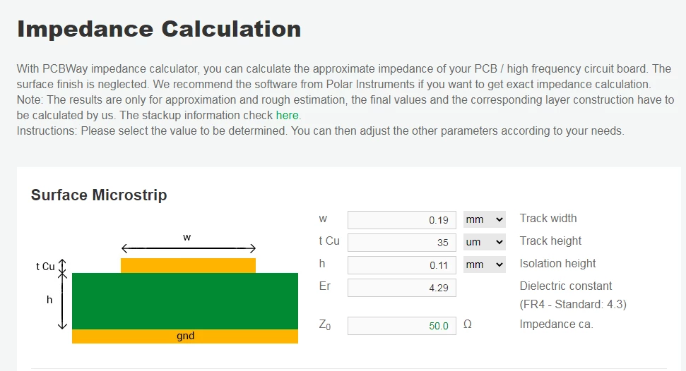

impedance trace width according to our PCB manufacturer (PCBWay) are here:

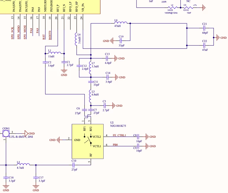

We made an RF network using the following reference:

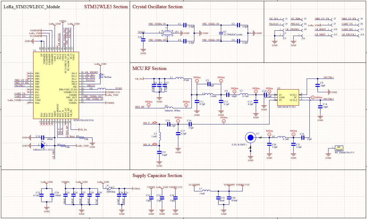

The schematic of my design is shown here:
_legacyfs_online_stmicro_images_0693W00000dDWiWQAW.pngWe are facing some problems while testing our custom nodes and the problem are described below

What on earth is going on with your TCXO circuit? It makes no sense, you have it wired like a crystal.
You should only need OSC_32MHZ_IN connection to STM32.
Check/confirm frequency.
State specific part used for TCXO, provide link to data sheet.

We have not used TCXO crystal.
The crystal part no. is NX2016SA-32MHZ-EXS00A-CS06654
The datasheet is attached here
Pl. let me know if any further information is needed

Omit L8 / C38, pin 2 / 4 on the XTAL should be ground, you have one of those pins connected, so should go via the case.
Validate the frequency. If you can escape via MCO / PA8 pin or similar.
Or divide as MCU clock via one of the TIM.
Make sure the HSE clock starts, and HSE_VALUE reflective of the frequency.

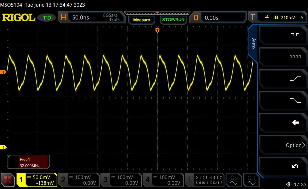

In our design, we do not use TCOX xtal. The L8 was the Do not Place (DNP) component. and the x'tal pins 2 & 4 are internally connected.
We tested the HSE clock on PA8/MCO pin and got the 32MHz clock. I have shared the waveform.

The waveform looked fine as I recall.
