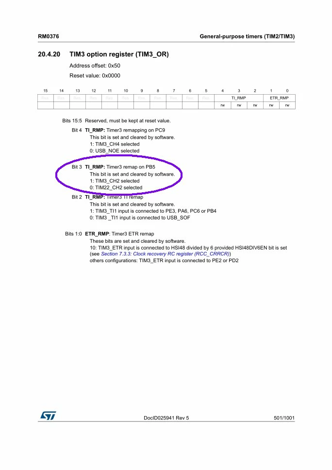

I have generated the code for PWM generation using STM32 CubeMX and it is working fine on B-l072Z-lrwan1.
But when I was trying to integrate same code with the existing Ping Pong example, I was not getting any PWM signal on respective pin. I have also configure the pin according to timer and channel with the help of datasheet and also check the alternate function for the pin.
I have tried different Timers but I am not getting any PWM signal at output.
Can anyone tell me, why this is happening?

Some of the code is not getting executed?
You could perhaps use the debugger and inspect the GPIO, TIM and RCC peripheral registers.
Check you have pulled all the init and msp code over.​

Rest of all code is executing well except PWM.
I am generating PWM on PB5 so Green LED Should be dim, but it remains off all the time.

Read out and check/post content of relevant GPIO and timer registers.

Registers configuration is right because the same configuration individually works fine but not with Ping Pong code.
I can't understand what is the problem ?
Below is the way I configured the registers and pin for PWM.

Can you please read out and check/post the content of the relevant GPIO and TIM registers?
waclawek.jan
September 15, 2019
Okay, so read out and check/post also this register:0690X00000ARDbkQAH.jpg

Thanks for your help.
cpc
cpcAuthor
September 23, 2019
Now I am getting the PWM. But the problem is SPI clock is affecting the PWM.
PWM is resetting according to SPI and when I disabled the SPI I am getting exact PWM as required.
According to me SPI clock is triggering the PWM.
What can be done to avoid this ?
