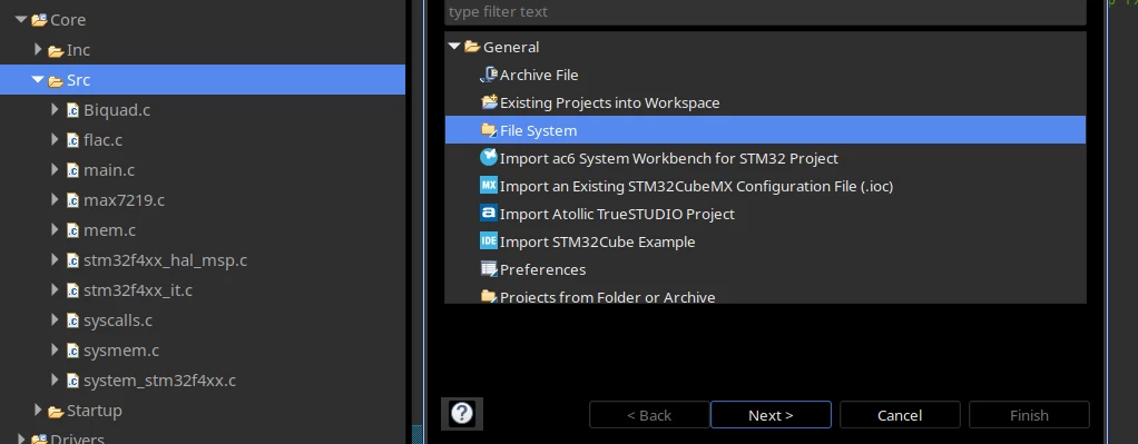

Hi everyone,
I'm trying to add a new file Alarm.c to my project. I added it in the Core>Src folder but I want to use it in a custom_app.c file that is located in another folder (STM32_WPAN>APP) as I use BLE. I included it to this file but when I compile, it doesn't find it in this file. How can I do to declare Alarm.c in one location and all my project's folder can find it?
Thank you
    How - just copy in ?
    To let the IDE know, some (.c or .h) file now part of your project, you have to use : import.
    So right click on the folder you want it to be, -> import -> from file sytem -> next ...

    Thank you for your answer. I simply created a new .c file in the Core>Src folder. I am new to STM32CubeIDE and C programmation. I would like to create a .c file with different functions in it that are used in main.c and custom_app.c files. How can I do this ?

    Almost same: right click on the folder you want it to be, -> new -> Source file
    + give name (no spaces, no special characters) , like : my_new.c
    Thats it.
    If you want to use functions in other files, you need to declare them inside of a header file or before you  use them. Simply including the source file in your application isn't going to do this.
    In your c file, define the functions:
    void my_function_1() {
    void my_function_2() {
    In your h file, declare it:
    void my_function_1();
    void my_function_2();
    In your other c files, include the header with the declarations.
    #include "my_functions.h"
