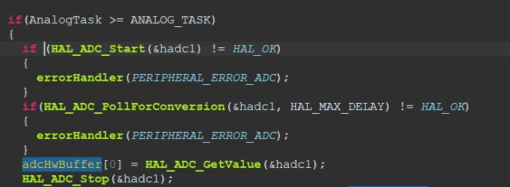

Hi community,
I have an application to sample the ADC and go to sleep(STOP2) mode. From the RM0434 got to know that cannot use the ADC/DMA interrupt as a wakeup source to get the ADC converted values
So I went with the Polling approach as shown in the snapshot. ADC_PollForConversion function is always giving HAL_Error. Can I get some help with this?
This code snippet is the ADC Init function. Also planning to use multiple channels going further

Aug 21, 2024 12:04 PM UTC
What does hadc->State indicate is the source of the error? Should also be able to step though HAL_ADC_PollForConversion to find this.

Aug 22, 2024 10:36 AM UTC
This is the place where HAL_Error is returned
Aug 22, 2024 12:33 PM UTC
Okay, so it sees that DMAEN is set, which it shouldn't be for polling mode. Find out where/why that's being set.
> hadc1.Init.DMAContinuousRequests = DISABLE;
This should make it disabled. Perhaps there is more relevant code that is not being shown?
